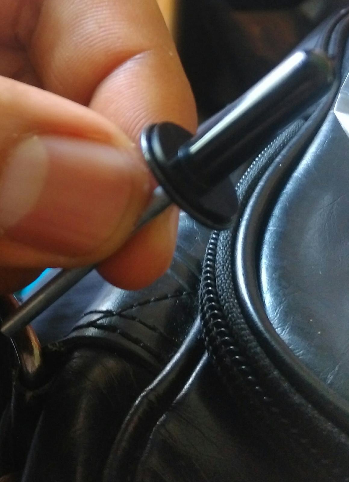

These are the rivets that I got thrown in for extra few quid...
Look rather diffrent from the skoda shop ones with a bigger head

I have just picked up the window regulator
I think they are the rivets to rivet the regulator to the door carrier.
http://www.skodapart...op-rivets-23458
