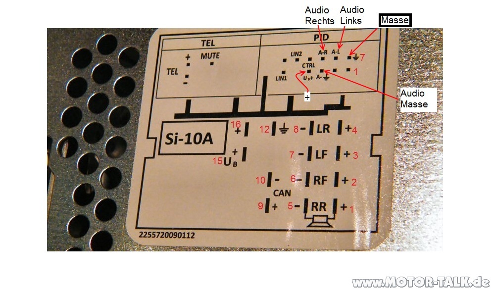

Hi, I'd like to ask if someone has any sort of diagram with labled pins on the PID or the dashboard ? I'm interested in which of the pins is power and audio. I'd like to use the connector to charge my phone and use it as audio in if possible. I found this topic (http://www.briskoda.net/forums/topic/292707-the-elegant-elegance/#entry3475487) but there is no wiring images.

I'd like to do exactly the same thing. Charge phone and use the pid as audio-in.
The media interfaces in the citigo are really poor and obsolete.

Thanks I'll check it out. I don't really think the PID is obsolete some of it features are useful but the navigation and multimedia are outdated...

Have you already checked it out? I found another sheet for the connector pin assignement (matches the image after rotation or so). Would be a project for the next summer.
Connector pin assignment for the ?RCD 215?.pdf
