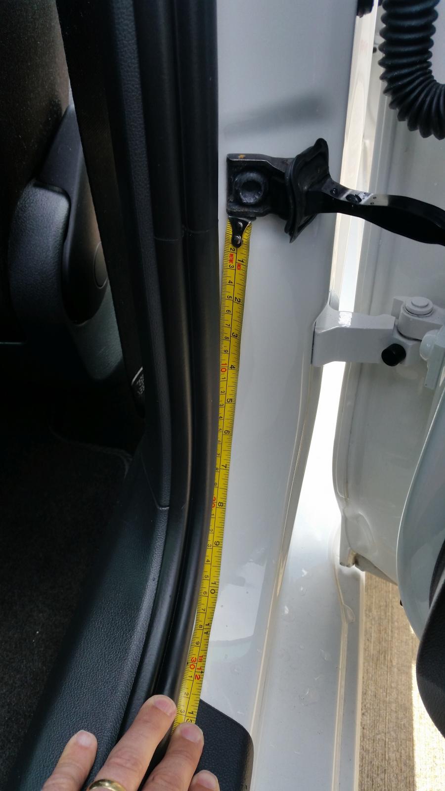

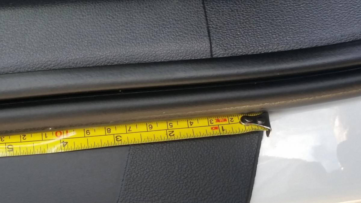

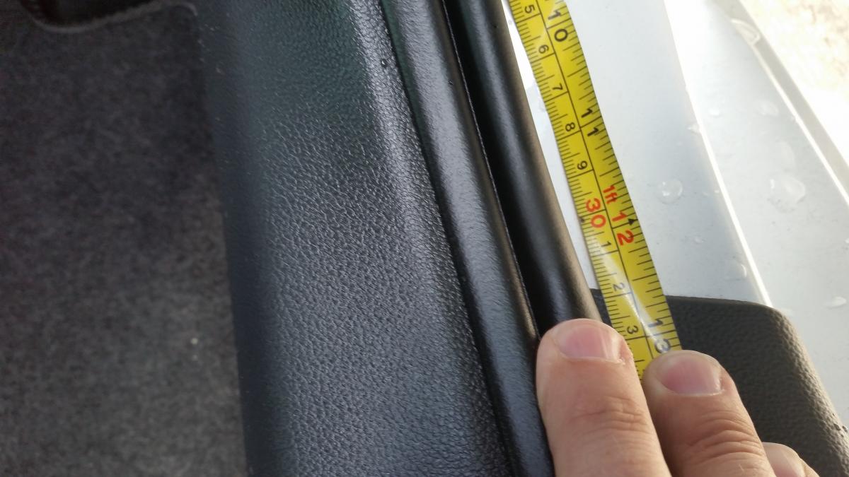

Hope these help. Self explanatory really. Genuine skoda part and fitment
front door one shows measurement from the join in the plastic strip that is located towards the front half of the trim
The rear show the measurement from the door hinge

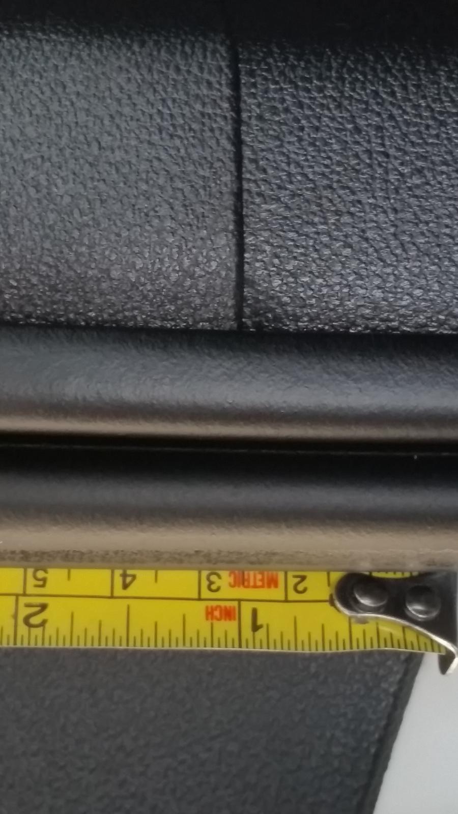

Here are mine i fitted myself i just slid the first one until it fitted the contore of the sill marked with some masking tape then measured. Transfered the measurements to the other side  Done the same to the rear (Genuine)
wire and skoda1982 - thank you both for the pics and the measurements, really appreciate you both making the effort.
