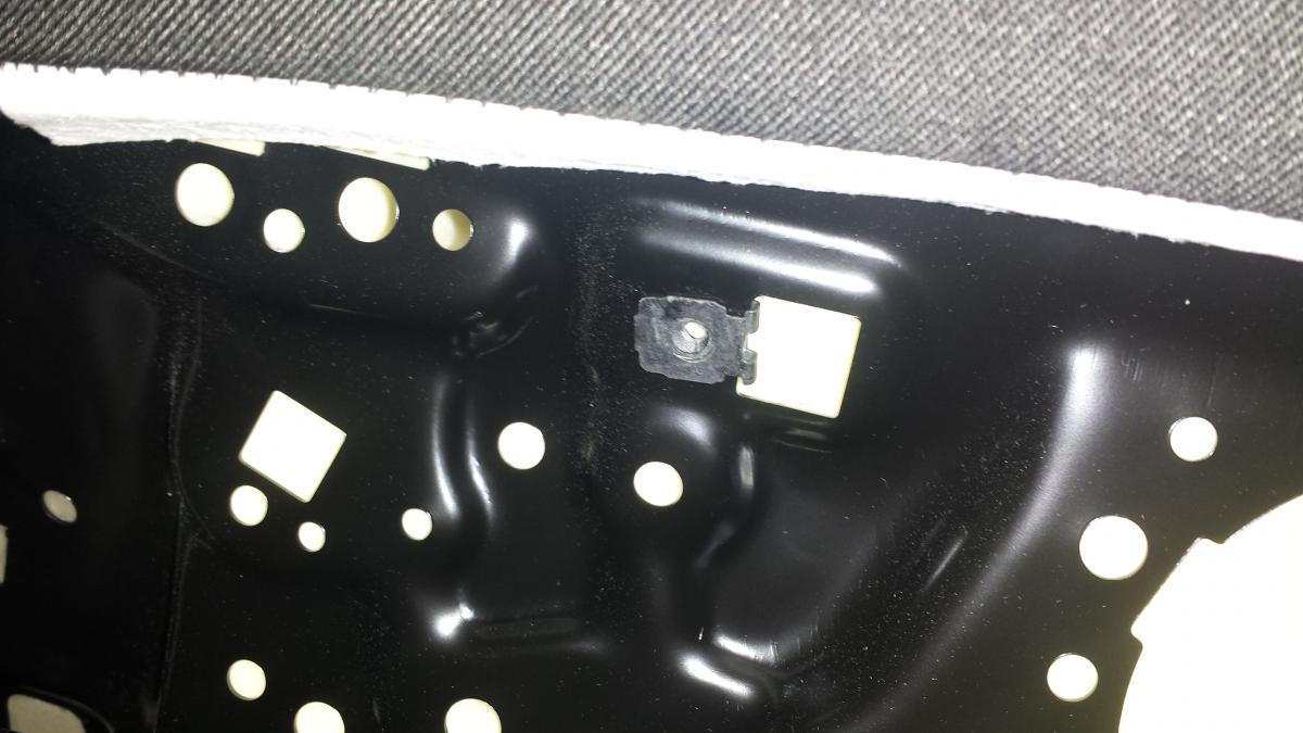

Anyone know what these square shaped threaded fasteners are called, Would anyone know there Skoda part number.... Im assuming they are pretty standard.
I need to order to be able to fit the under seat storage....the Skoda parts syatem shows the screws but not the clips.
https://b-a.d-cd.net/3fa4754s-960.jpg
Spire clips?
Is that the same as the clip that hold on the engine undertray?
If so, it's PN  8D0805960, I think.
Same on VW Golf MK7 ...............speed nut item 4 from here
http://www.partsbase.org/vw/golf-variant-4motion-golf-eu-2013-golf-au-d-000-001-88100-seat/
4 N 90088003
speed nut; M6X17X14
