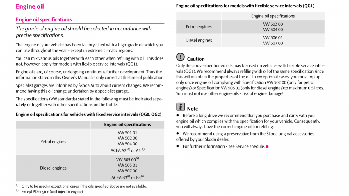

vw507 is the spec you need - it is the longlife code specific to diesel engines
Edited by STSKODA
From the Mk1 Octavia manual.
