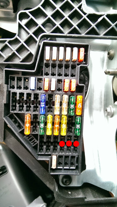

On another note, I was going to wire the Power Magic Pro by piggybacking existing fuses, but it already has two fuse plugs wired up. Would there be free 'BATT +' and 'ACC +' in the fuse box to tap in to?

Any suggestion on which mini fuse slots I should tap into since there's no accessory position?

It'll depend what options your car has to which fuse locations are free.
I found an unused switched fuse by using a multimeter when I fitted my mobius. I believe the three I marked on the picture were switched for my car.

Thanks, langers. I'll have a play around with my multimeter and see. If I get stuck, I'll take you up on your offer!

Within the fusebox are some empty slots, with only a powered input. A spade connector to one of these that is ignition live powers my USB dropper.
