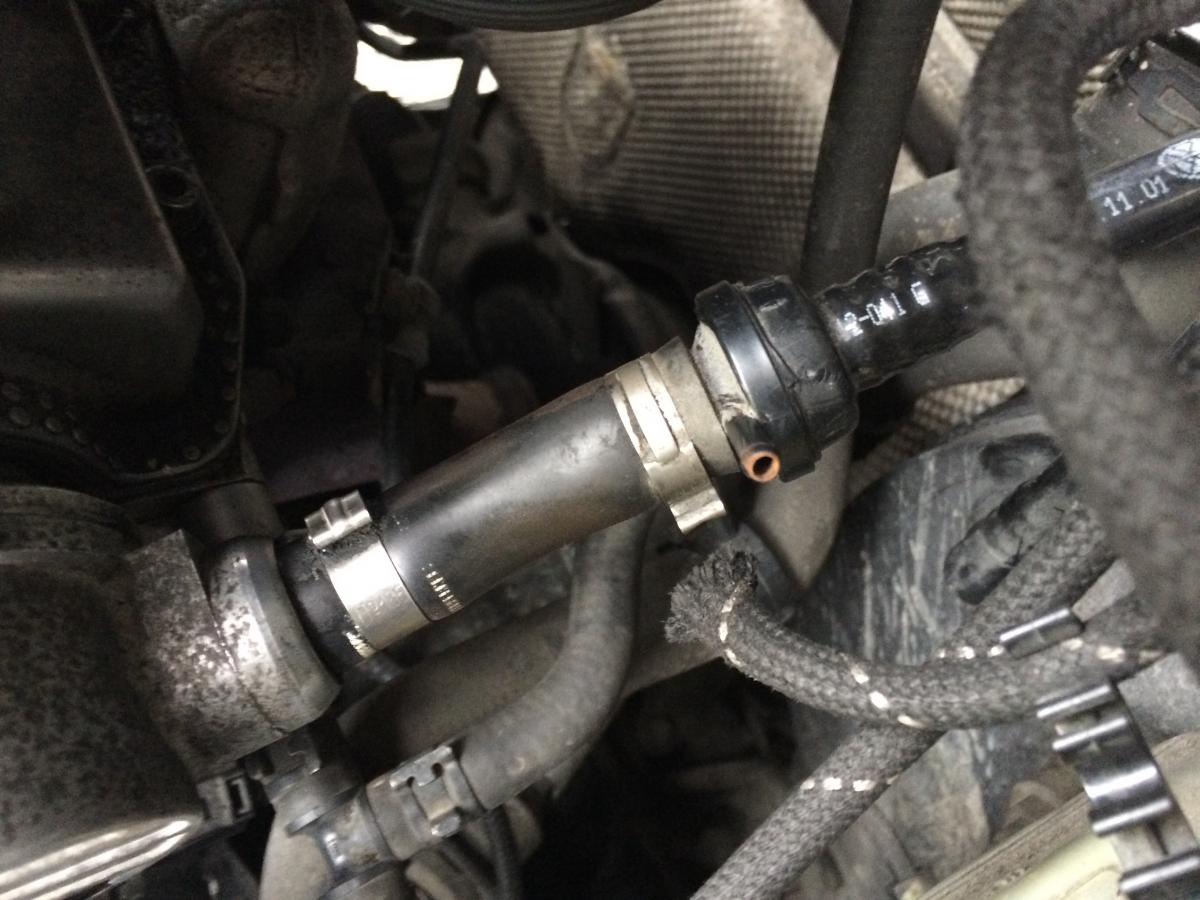

Problem solved.
My conclusions were all wrong, the vacuum is produced in the vacuum pump for brake system.
Problem was that the tiny vacuum suction tube was gunged up with brownish dust, similar to what was blown out of the black&white NRV in the vacuum lines. Picture shows after cleaning.
Turbo is now functioning as normal, but I guess I'd better take a close look at that NRV again, perhaps it needs to be renewed.post-108640-0-93508100-1437473820_thumb.jpg
