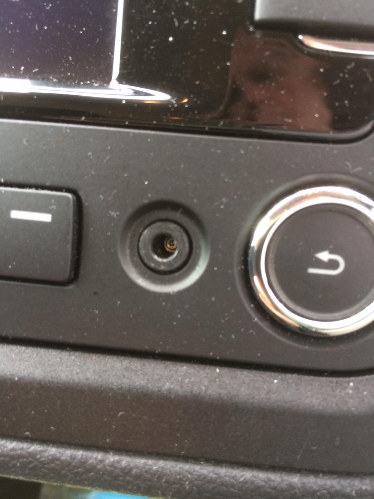

The second Q is the aux socket on the front of the head unit: the handbook says it's a standard mini jack socket, but it ain't. The socket seems to have a central pin, as if to take the kind of plug on an old Nokia phone charger,

If this is the case then yes, it does take a standard 3.5mm jack like you'd find on the end of most headphones. It sounds like someone may have snapped a connector off inside the headunit if it has a central pin. A picture of the jack would confirm this but I'd expect the headunit to look something like this:

Can you take a picture of the aux in jack so we can see what the problem with it is?
I'll do my best, had trouble posting pics on other forums, though................
Meanwhile, thanks again for your input!
It was difficult to get ultra close-up with my phone, but I think the innards of the socket can be seen.
Anyone have any ideas, please?
Thanks in advancepost-132632-0-29137500-1438921121_thumb.jpgpost-132632-0-84652700-1438921139_thumb.jpg
I would definitely guess at it being part of a plug that's broken off inside.
The more interesting question is how to get it out! I suspect the right answer it to open up the unit and see if you can push it out from inside but that's probably quite a daunting task depending on your skill set. I've got one I've taken apart at work so I'll have a look, I think it's about 4 screws to get into the unit and then loads to get to the front circuit board but I can't remember how that socket is mounted.

Try long nose players to pull out or super glue a small screw on to the end and pull out.
