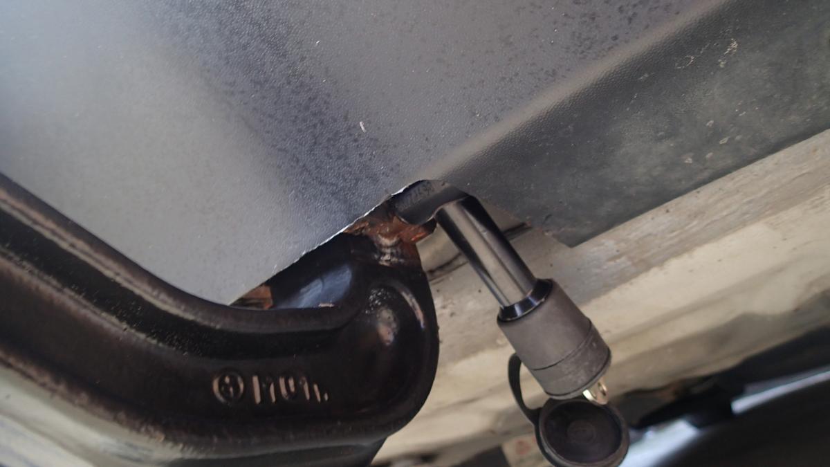

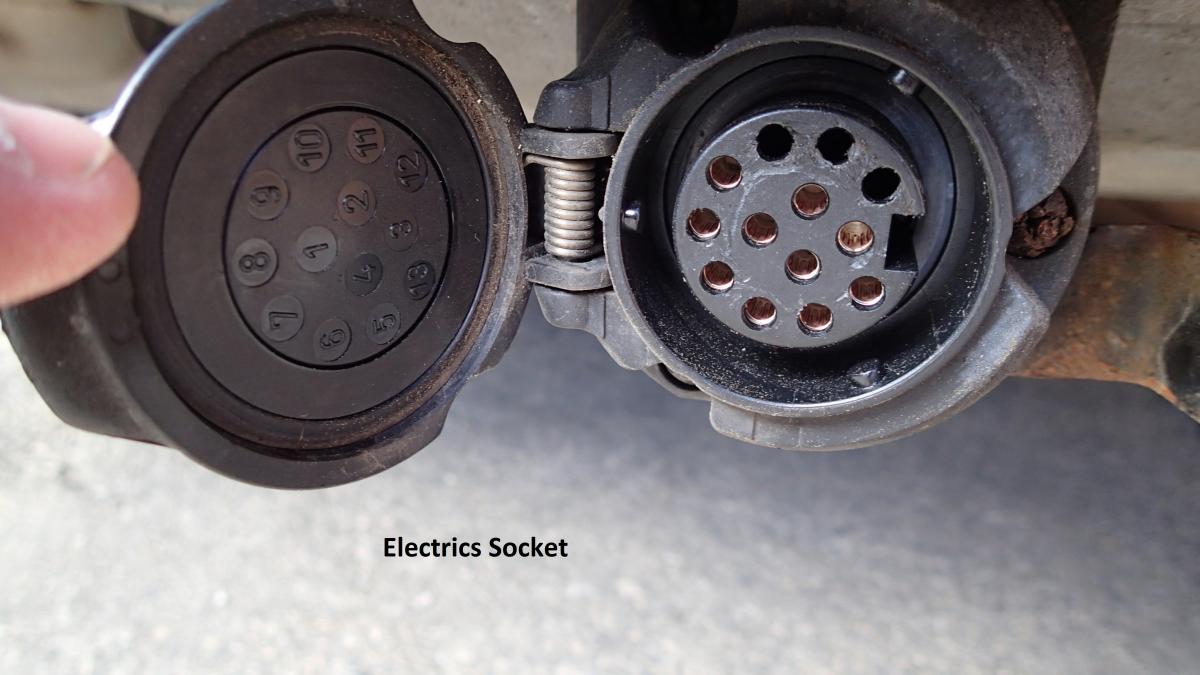

I've got that towbar & it's a pig to deal with unless you keep everything well lubricated. Mine is kept in it's foam housing in the spare wheel and I've only used it a handful of times, but last time it needed an hour's work to lube the housing, the hinge of the electrics socket and the locking mechanism. The plastic plug protecting the housing doesn't keep out salt spray. If you're going to use it a lot, I would fit it and leave it fitted, but keep the drop-down electric socket hinge well greased to save yourself a lot of frustration.
Excellent images.
Did you have any instructions as I have tried yanking on the plastic cap with a pair of pliers but it is not budging as yet?
Just left soaking in WD40 for another go later.

I found this thread on Google while trying to figure out how to remove the towball from my Octy Scout. I got it out in the end, after regular WD 40, and finally today, a lump hammer. I wasn't keen on forcing it until I was sure how the locking mechanism worked. But now I know it is properly locked and safe to use.

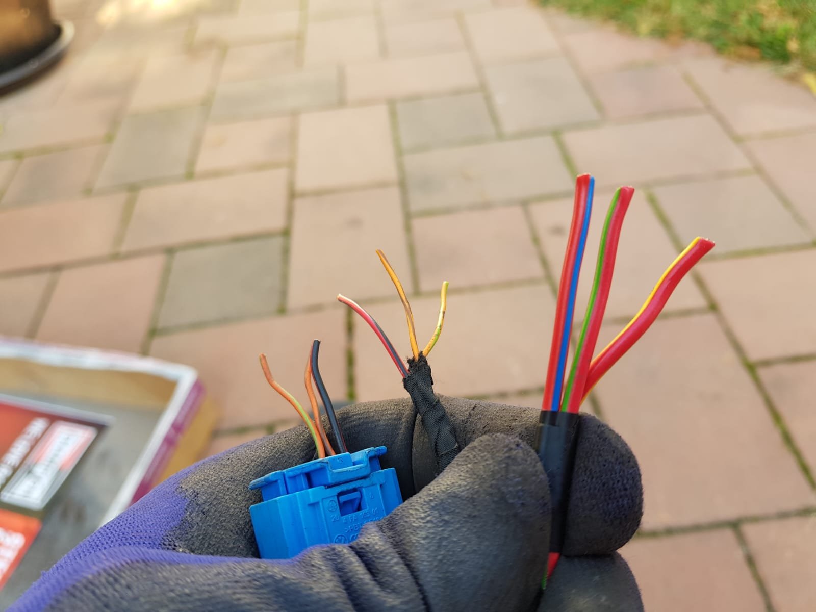

Hello,
Please help me with fitting instruction for town bar electrical kit Skoda Octavia Mk II (2004 - 2013) OE reference EEA 600 001 C E4. My electrical cable was removed from a similar car Octavia II 2012 and I don't know how to make the connections on the electrical panel and CAN connector. I attached a picture with my electrical cables. I downloaded the Jaeger instruction for 21220511J but the color cable codes are different and maybe someone can help me with the OE fitting instruction for EEA 600 001 C E4 or with some tips how to connect properly my cables.
Thanks a lot in advance and have an excellent day
Ciprian

Hi. I've just bought a Octavia 2013 with the same towbar. I don't manage to remove the plastic plug. Probably rusted, but is there a trick to release it?
