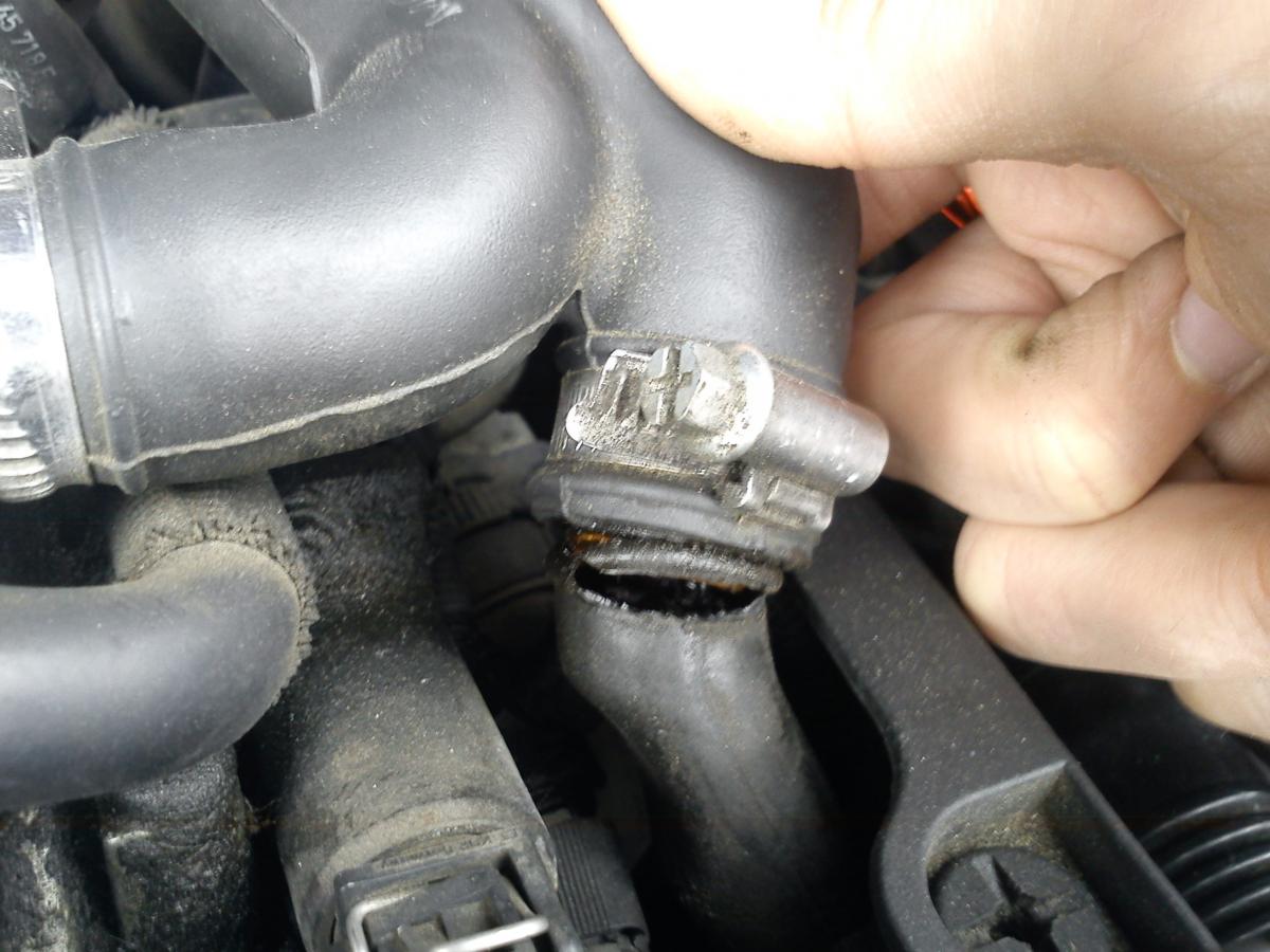

I was just wondering if it had been tuned so a software issue could be ruled out, which is what my 17705 turned out to be. Pipework would be my first thing, won't always be easily visible, holes in intercoolers aren't unheard of but you wouldn't really see that for example.
pipework it is.
pipework it is.
I had exactly the same split, bit of a favourite place. Could explain it, however when I found my split I cheered as I though all was solved, and whilst idle and running got a bit better it didn't solve my boost drop off issue. Anyway it may solve yours, news fixing anyway so see what happens after. If it's still the same or only a little better try a smoke test.
