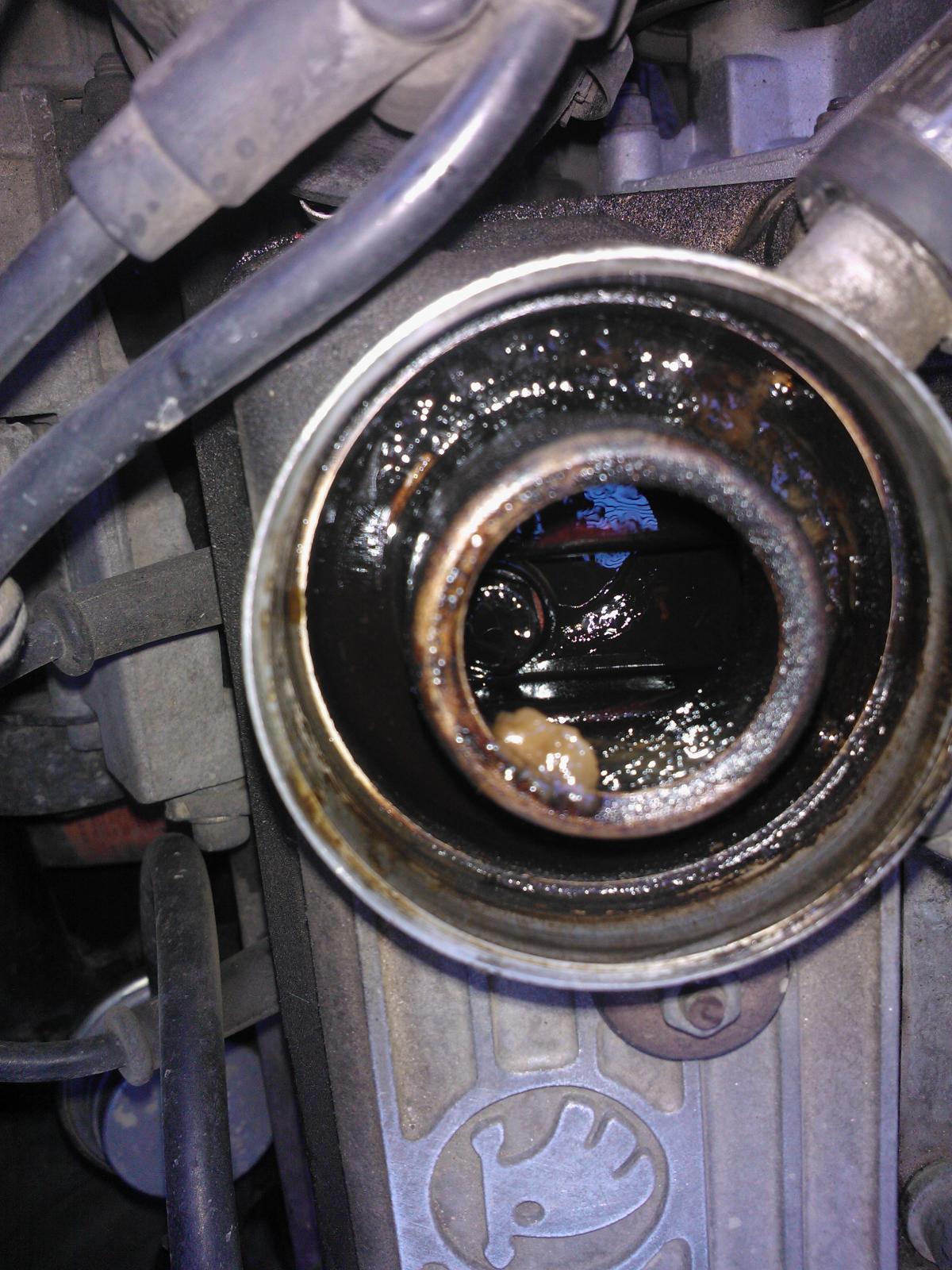

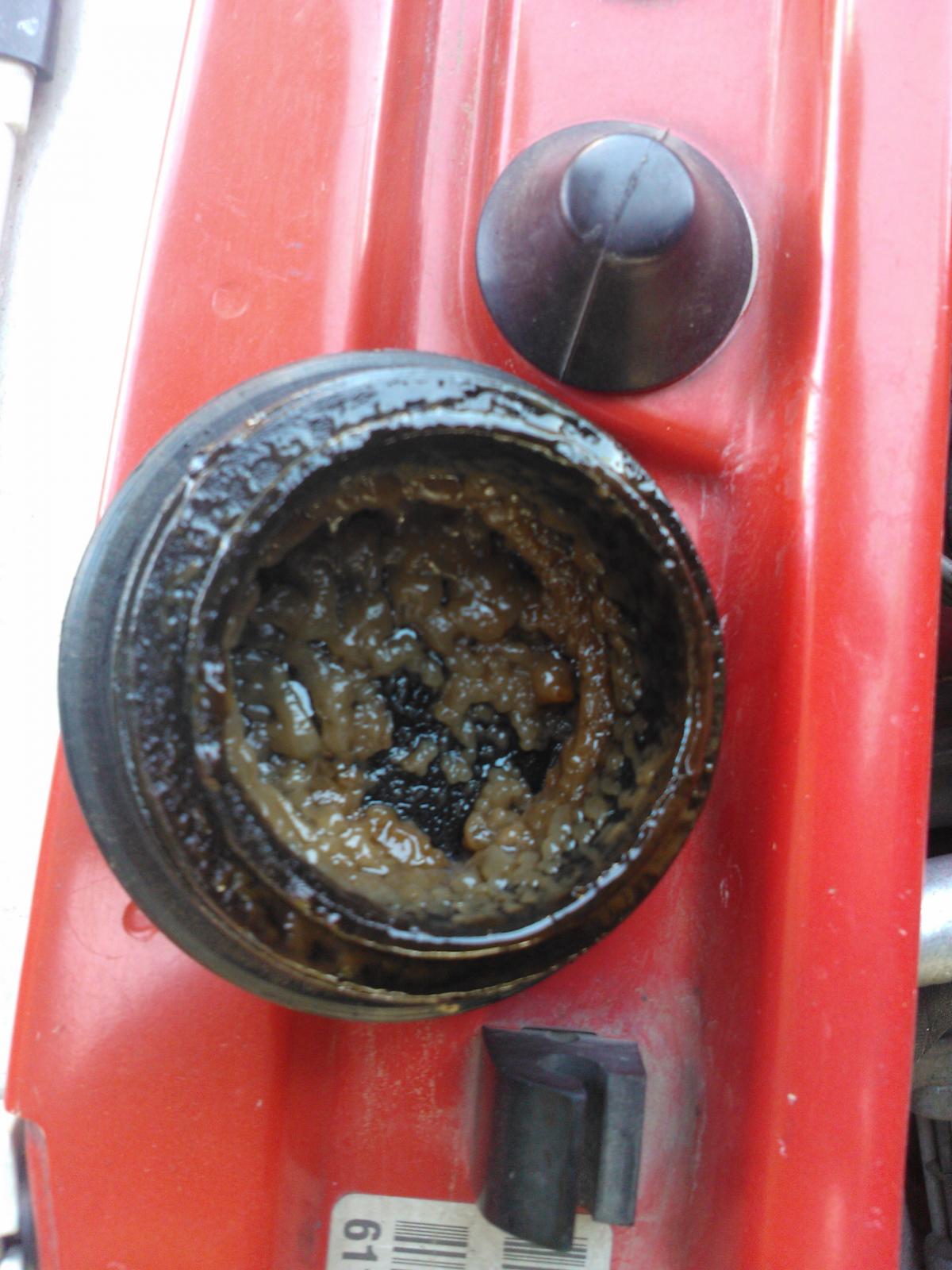

that substance is this? someone can tell me?
I have a post already talking about the problems of my felicia, but I opened this again because I did not know how to put these photos in the old post.
Reviewing felicia can think lifting the lid of the oil and I find this substance in the top and it seems that this engine within spitting out.
There was also water, so I imagine that Felicia has problems with head gasket, I'm right. for more information if they want in the post "tuning Felicia 1.3" I put my car problems

Short trips and overdue oil change. Lots of condensate in that
Wrong. That is way over condensation. That is oil / coolant emulsion from a blown head gasket. His engine got overheated (110 C) from a bad cooling system.
Ismael, you are looking at an expensive repair job. You have to:
  • remove the cylinder head
  • check it for cracks
  • resurface it (most probably it is warped)
  • check the engine block for straightness
  • check the valves and the valve stem seals for proper sealing
  • install new head gasket
For now go on with measuring the compression and if possible do a cylinder leak down test. The latter will tell you exactly what is damaged.
Do not drive the car like that. You risk destroying the engine totally.

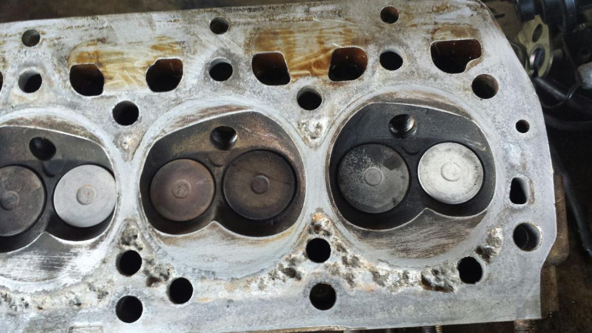

hola de nuevo. Bueno les cuento...
He dejado el Felicia en el taller  y resulta que tiene la culata deformada y podrida, por eso toda la perdida de potencia etc,etc
No he podido estar en  el proceso de desmonte del felicia pero les dejo una foto de la condicion de la culata.
Ahora me estan buscando una culata de segunda mano ya que no me recomiendan repararla en este estado. Me han dicho que se puede rellenar pero que eso no garantiza una buena reparación.
Y me diran en unos dias.
Yeah... as expected... the head is damaged beyond repair. Based on corrosion extent, the main cause of failure is bad coolant (it became acid) and cooling system not flushed properly. That is a lesson for all of us.
Keep us posted. And remember, a second hand cylinder head must be checked for cracks and straightness too. The garage should give you a 5,000 miles guarantee at least.

Don't forget to check and repair what caused the overheating problem. The cooling system. If the cylinder head was so badly corroded, I would suspect everything metallic: the water pump, the radiator, the engine block (!), the heater. If you don't do that properly, the head gasket will blow up again.

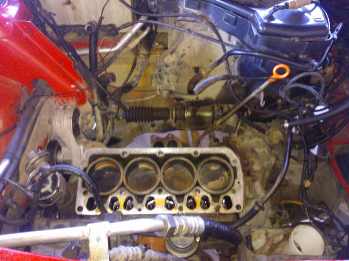

This has been the engine after removal.
I hope that this week and it delivered
