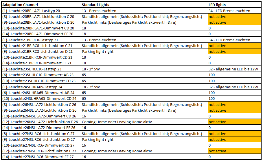

If the plugs are different then you will need to buy or make a small adaptor lead, once done you then need to change a few of the adaptations in the BCM for led operation of the tail / brake lights.

xpower, would you in all your VCDS wisdom tell the world what channels may need changing for converting from basic rear clusters to LED ones? This question has been raised on several threads before, but the answer has usually been to go compare the adaptations map between cars with basic and LED cluster, and work it out yourself. Unfortunately it's a bit too baffling for me.

You could complete an adaptation map of the 09 central module and export to excel.
If you can send it to me I can advise on the correct channels.

I'm doing a set on a hatch this weekend, I'll post up the outcome. The user has already fitted them, so the connectors must be the same.
I reckon half a dozen adaptation channels need changing for bulb type and brightness and that will be it, shouldn't take too long to work it out.
OK, for the hatch 26 adaptation channels need changing, 10 of which are optional.
I'll make the changes tomorrow and if all works well will post the method in the sticky thread.
The connectors on the rear of the light units are the same - it took @Waqar all of 20 minutes to swap both rear light units and the necessary bulbs over (fog, indicator & reverse).
Posted it in the sticky thread anyway, it is fairly simple stuff, just needed to make sure I had covered all of the changes.
Not sure if the estate will be the same channels, I'm just comparing to my estate now.
Yep, exactly the same for the estate as well.
You don't have to change the ones highlighted in orange, but to match factory coding you may as well.

I can confirrm it works perfectly as well
