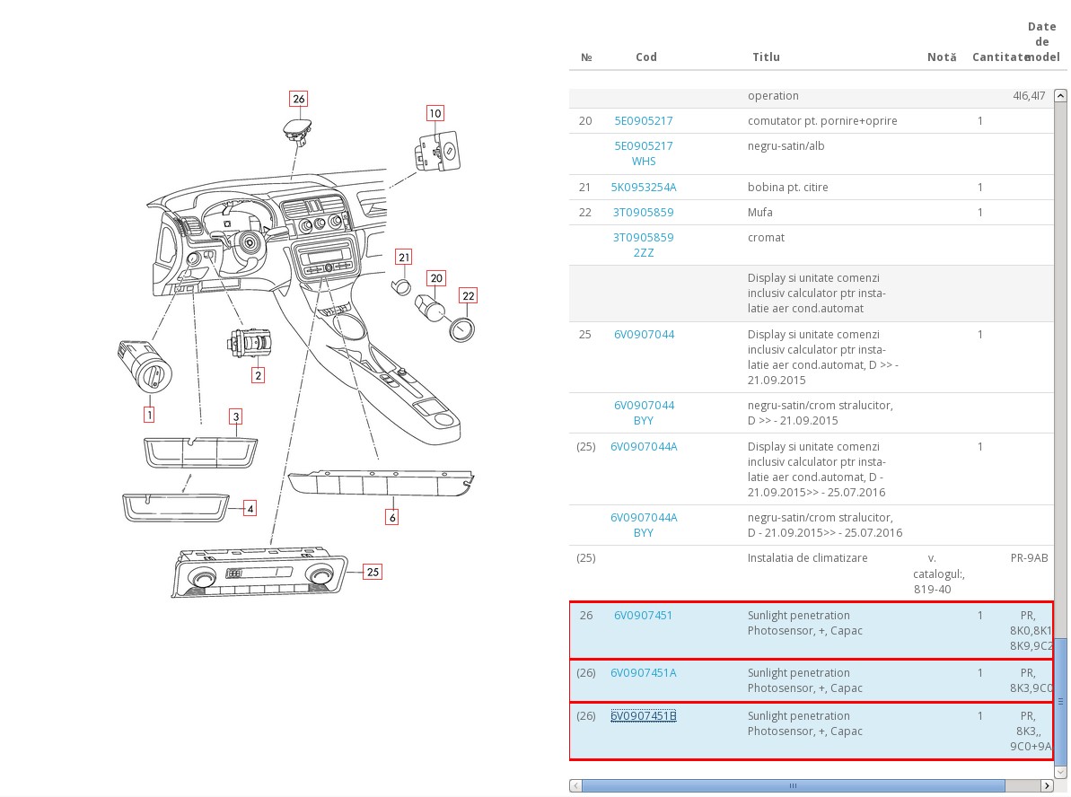

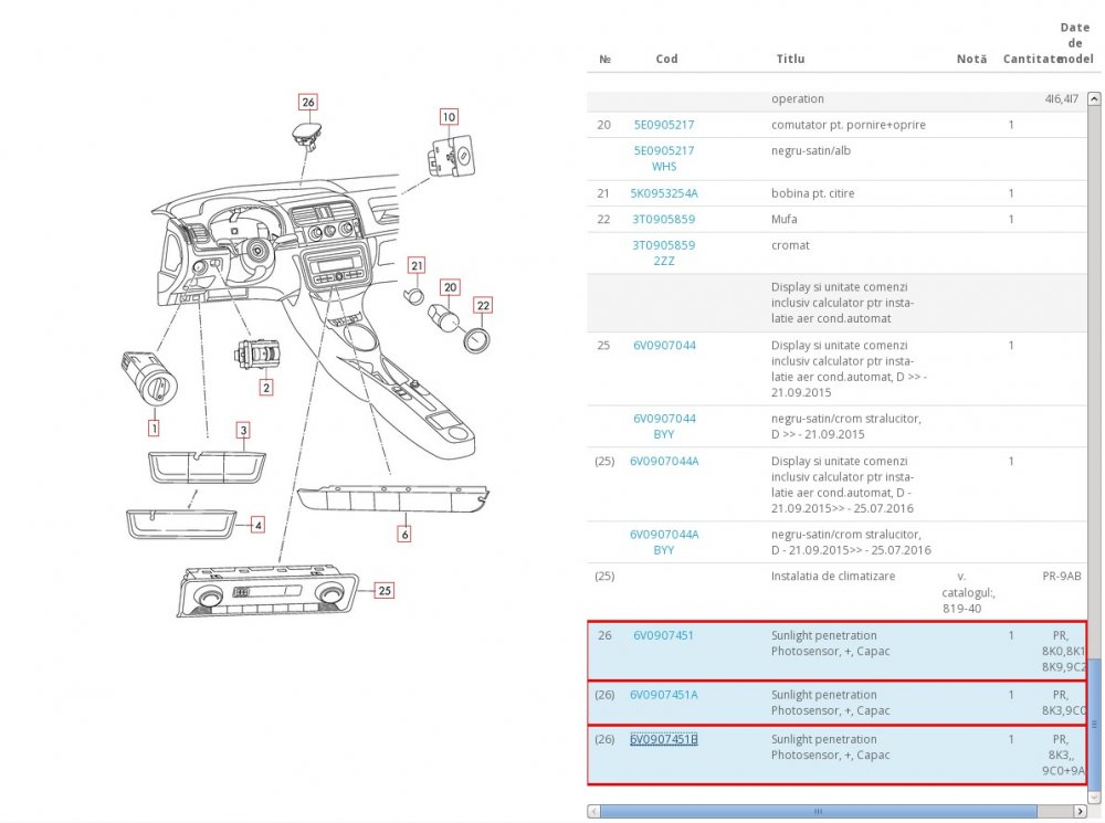

I know this is an old topic but after just buying my wife a new Skoda Fabia Mk3 without automatic light sensor I searched online and found that the part no. for just the automatic lights sensor is: 6V0907451A. Hope it helps anyone who will want to do only a minor retrofit.
Edited by sebidraghici

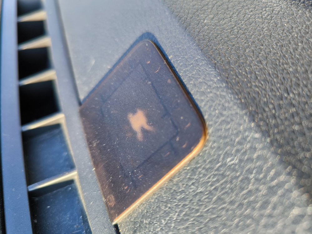

Since I bought recently Fabia 2019, and have this sensor, what have to be done to make auto lights. New switch and coding or wiring also?
