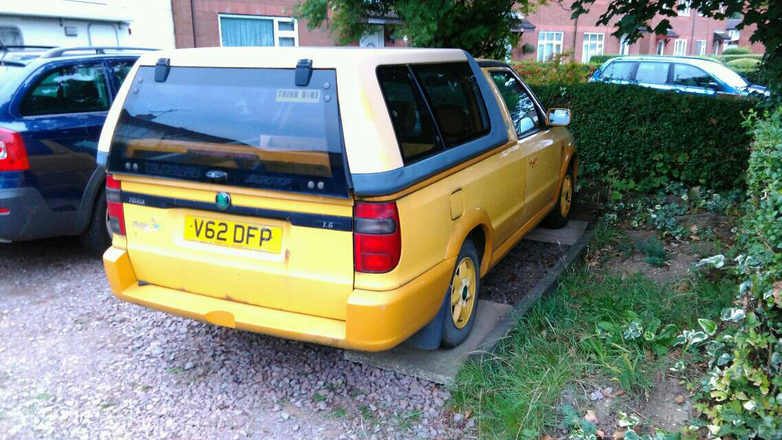

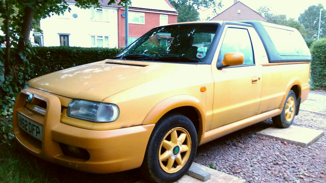

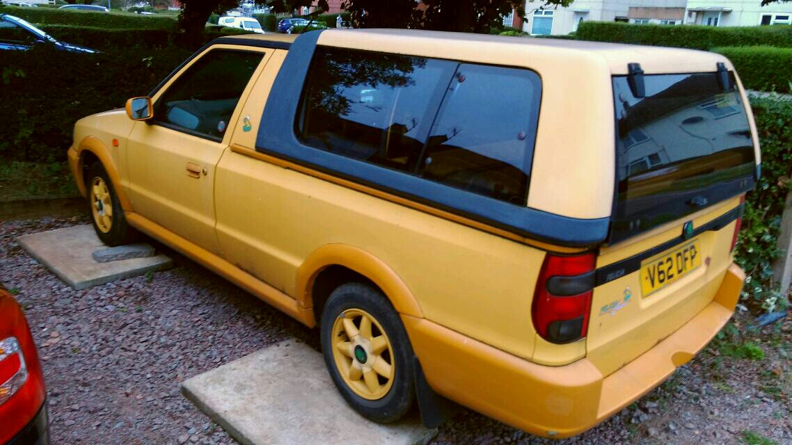

Hi. Today I finally acquired the Felicia Fun I've been after for quite a while. It's a two owners, full service history, below average mileage example, which also happens to be a bit of a state. Won't be doing anything with it straight away cos the wife and I are on holiday next week. In the meantime, here's some pics of it

Looking great on the outside. No corrosion?

Hi. It's a nickname I got when I was a teenager. Long story. I am indeed a bloke, and have been married for around 6 years. The Fun isn't too bad really, needs new front wings, the sills are really crumbly at the rear jacking points on both sides and the rear tubs are really bad, but the nearside is the worst. I understand they all do that. The previous owner didn't want to part with it, but didn't have the money to sort it. I decided I had to try to save it.
