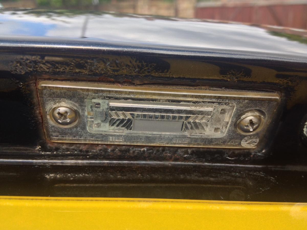

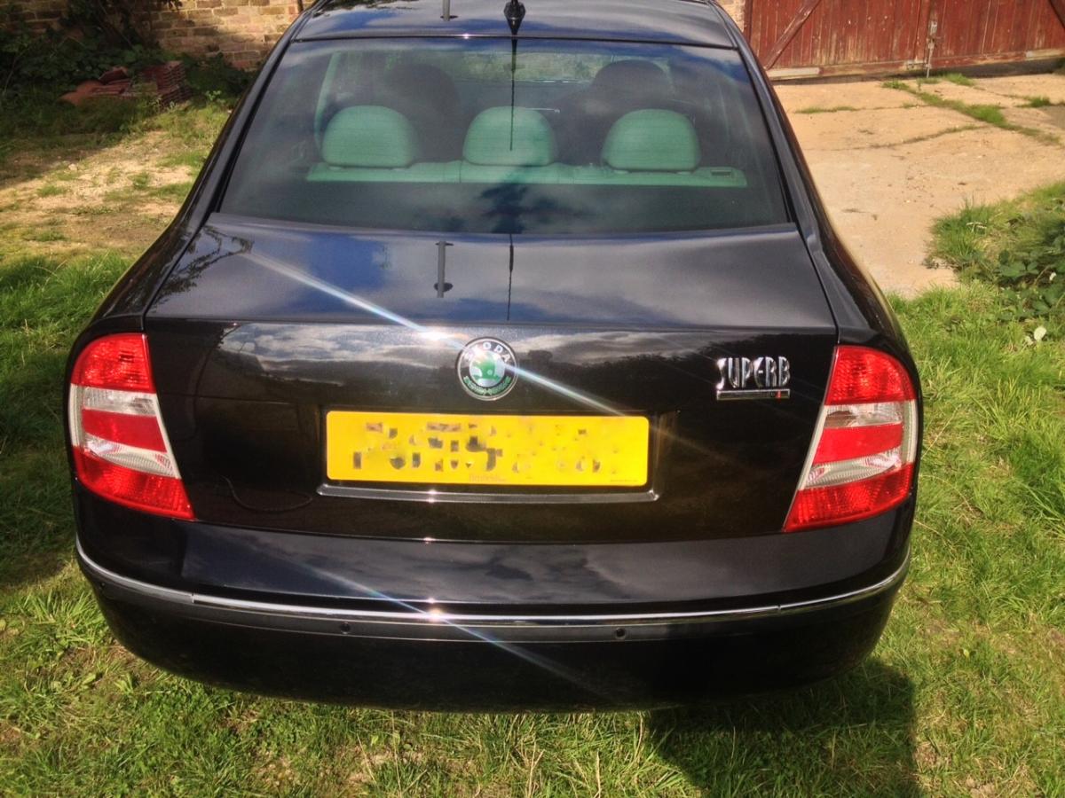

Another thumbs-up for SUK today too - they've agreed to repair the corrosion under the 10 year Paint warranty on the attached pics of the boot lid of our MKI - I'm delighted! Once again, the car has been service/repaired from new by authorised dealers.
