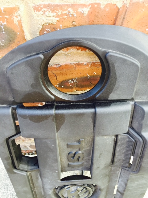

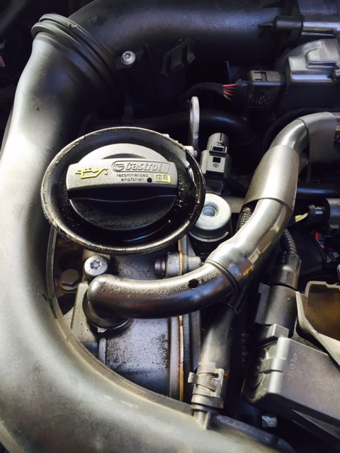

Turned off the engine gave it a couple of minutes then restarted and all good.  Set off but the car just doesn’t feel as smooth and sounds rough.  Anyway gets home and looks under the bonnet and sees oil all over the filler cap and underneath the plastic cover.  Checks oil and it’s also low so need to put in 0.7 litre.
Now I check the oil every week and the area around the filler cap is always clean and was full before the service.  (Added some pics of what it looked like after service)
