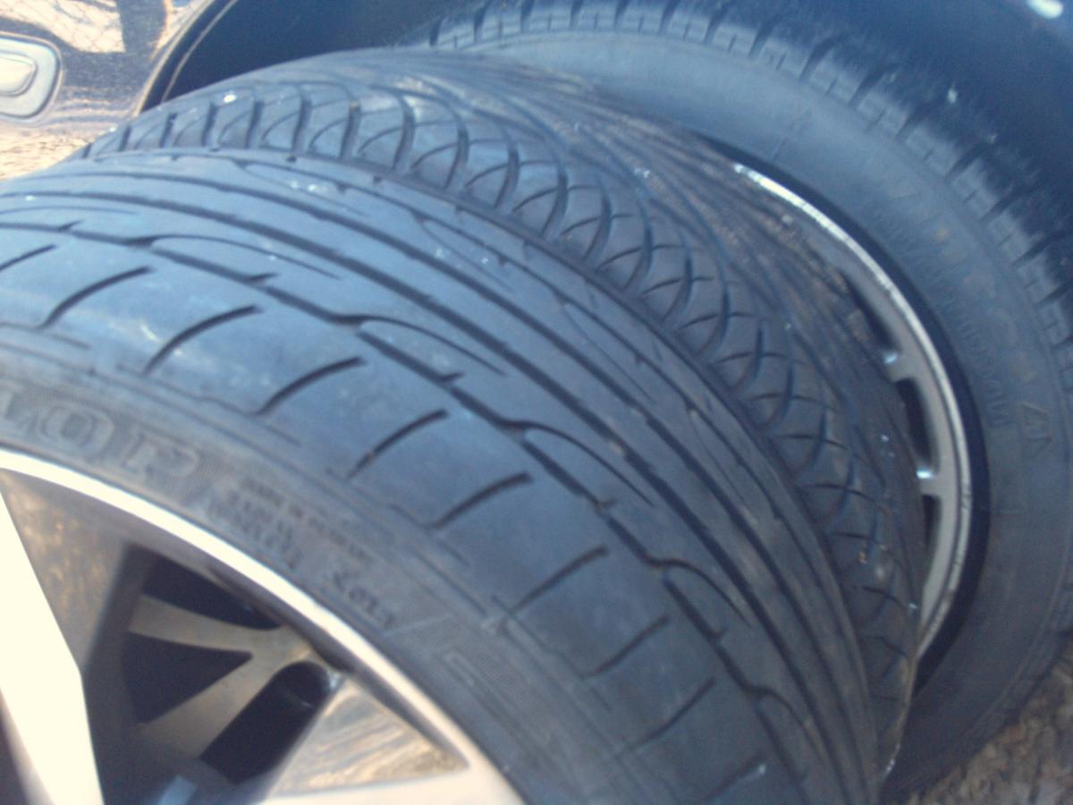

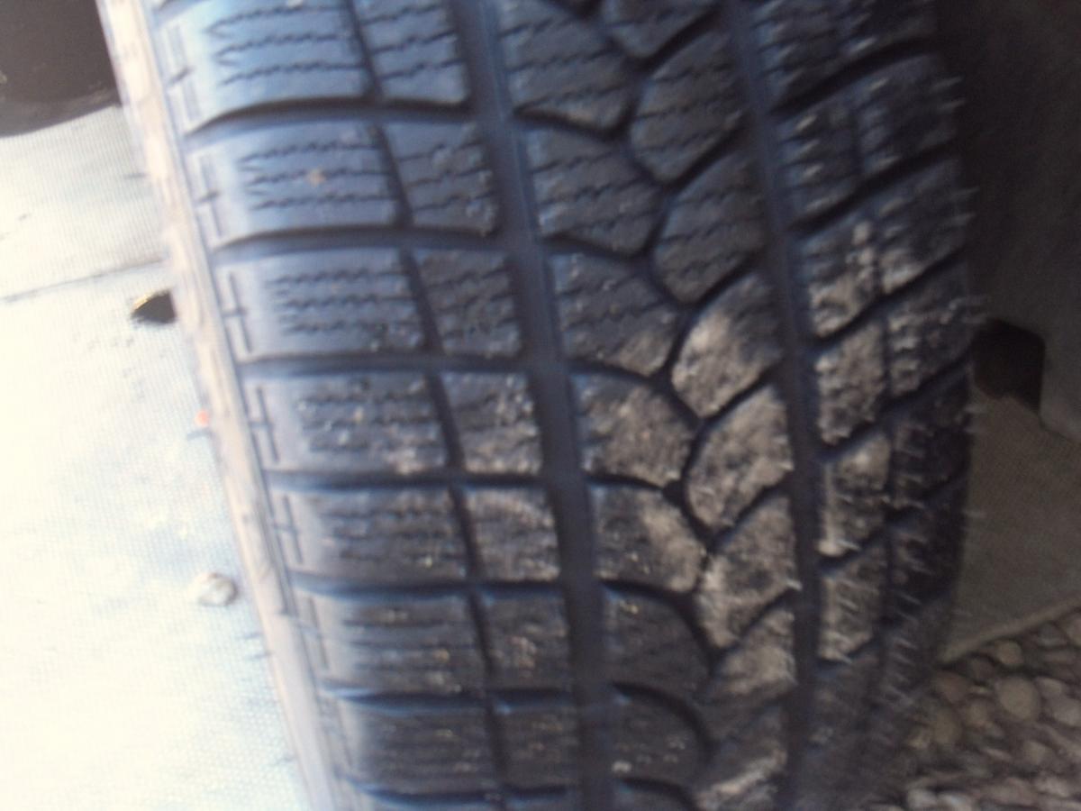

From the Left are 17 x 7J rims with 205/40 R 17 & 215/40 R 17,
& on the right are 225/45 R 17 on 7.5J rims.
Left to right, Summer, M+S & Winter  tyre.
