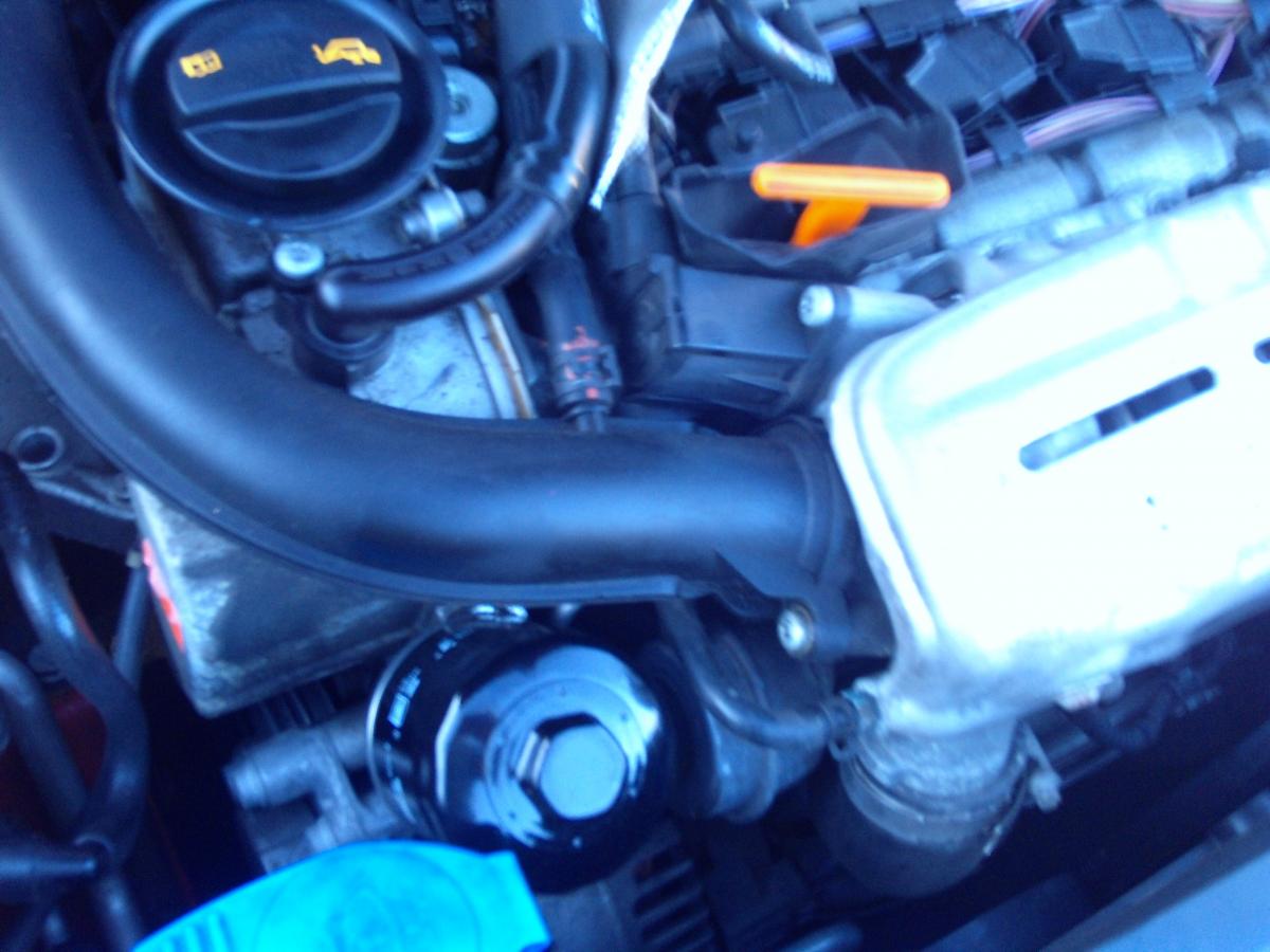

The yellow engine shaped light. The garage chap said the spark plug change had been a nightmare so its possible,though the engine is running so smooth,that the coil pack needs looking at which i will do first light. I have ordered the tool for the removal of the coil packs enabling me to do future plug changes myself. My intentions are to keep the car very long term so it looks like my days "on the tools" are to be re-lived. Thank you as ever George for your input. Oh and the out going plugs after 20112 miles were all a very nice colour.Brake pads out had heaps of meat left so they can go in the "save just in case" box.

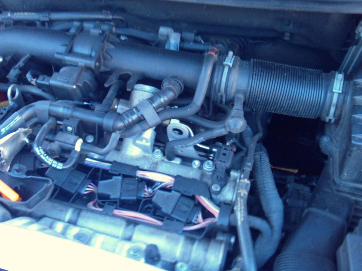

Light still on,oil level OK I specified a gap of .6 in writing as I have the bluespark tuning box( on lowest economy level). I gave the car a ten mile drive to see if the light might go out,but no joy. I noticed its started going between just over and under the 1000 rpm on idle...just having a cuppa while she cools then I will take the cover off for a visual check of coil packs. If nothing obvious I guess its back to the garage for a vcd scan and see what that shows. Having serviced my polo and my sons golf for a few years now I can't think that the simple tasks placed on the garage were too much for them !

Took cover off heard very small hiss,located pipe and refitted turned engine on no hiss no yellow engine on display. Living happy ever after....today anyway

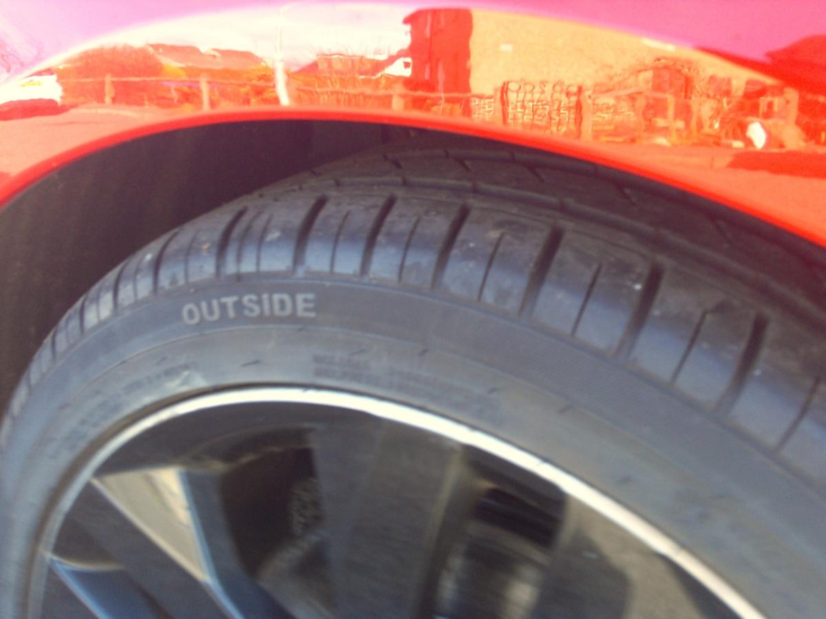

Hi George did you use 5w 40 for oil and are you still using hifly for the tyres?, I've just starting using comma 5w 40 type G instead of 5w 30 ps cars looking good by the way kind regards longest owner of the Vrs on briskoda lol Mick
Yes this time in is, Asda 5w 40 Full Synthetic.
The Hyfly HF805 215/40 R 17 Tyres are on, they have been great.
(But only on the Front, Pirelli Zero Nero 205/40 R17 on the rear until winter comes.)

Apologies to take this thread offline, I'm changing my front tyres this week and seriously considering the hyfly, at the minute I've got 205 40 R17 Yokohama paradas all round what would you recommend this time? Or would you opt for some winters or stick to an all rounder any advice much appreciated Mick
All i can say is i seriously dislike the ones you have on now on a vRS.
The Hilfly are not Winter Tyres.
I have had 215/40 R 17 Goodride SV308 on in the Snow which were M+S Marked but not actually Cold weather winter tyres and they were good, similar price, about £60 each.
