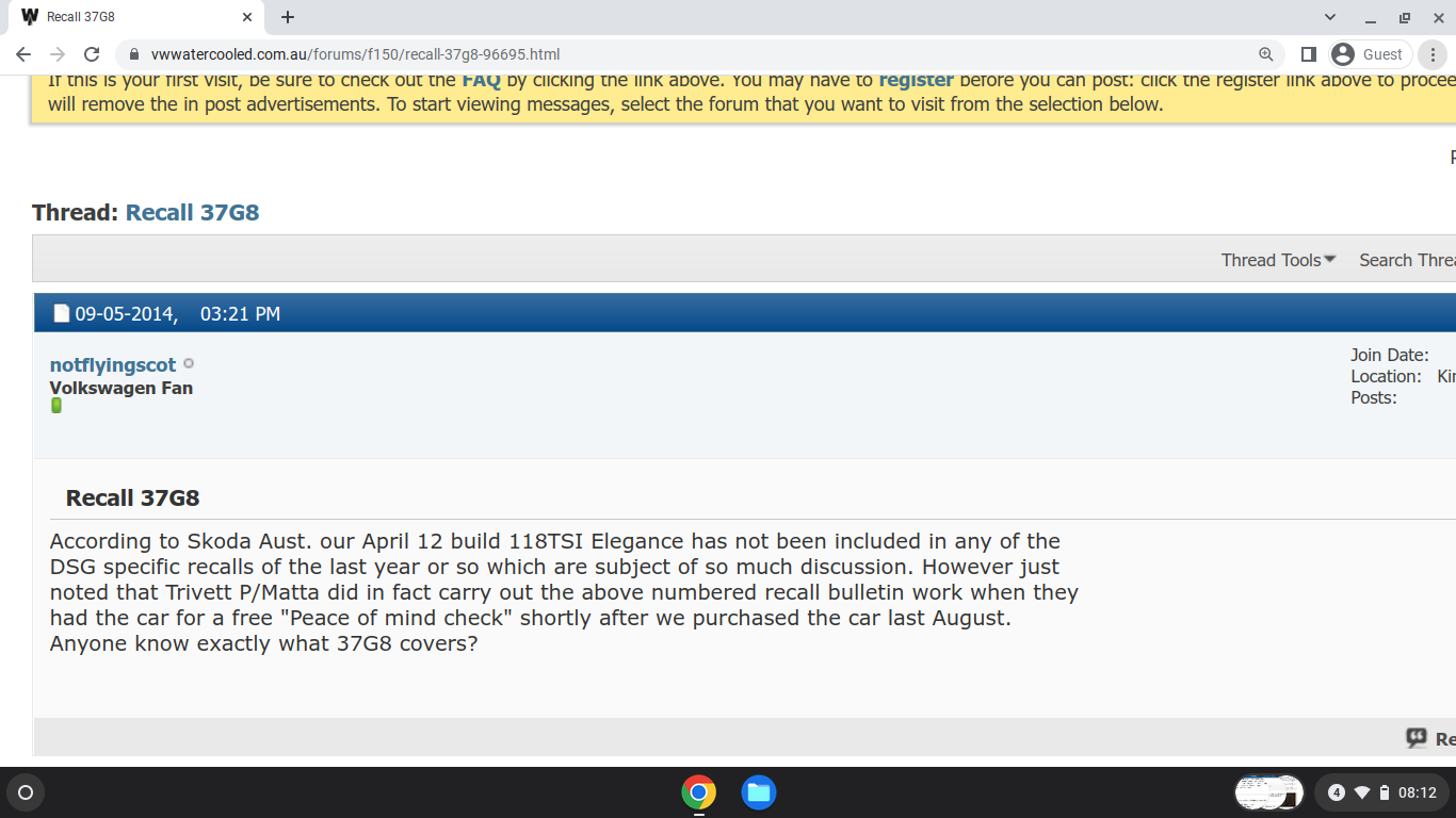

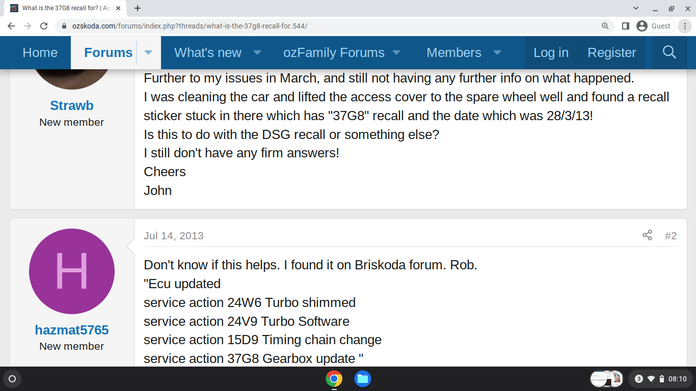

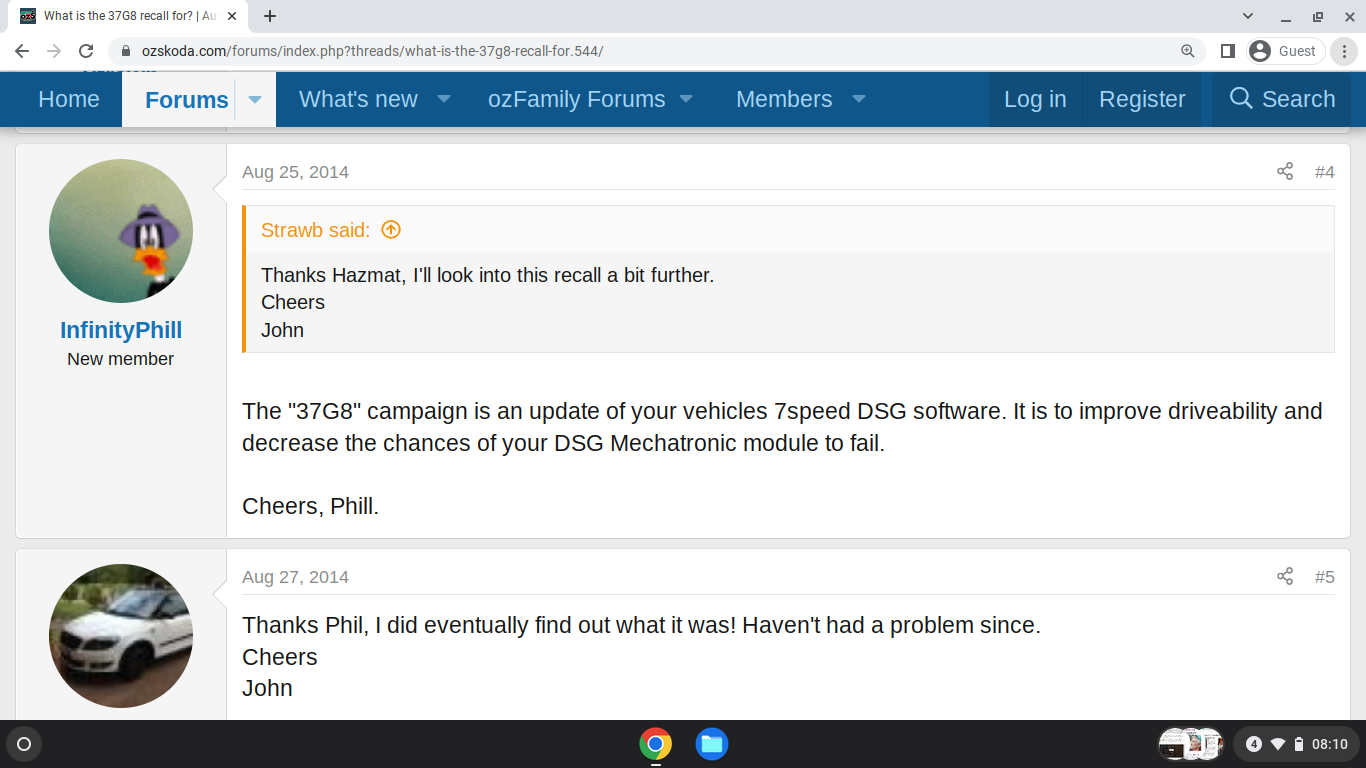

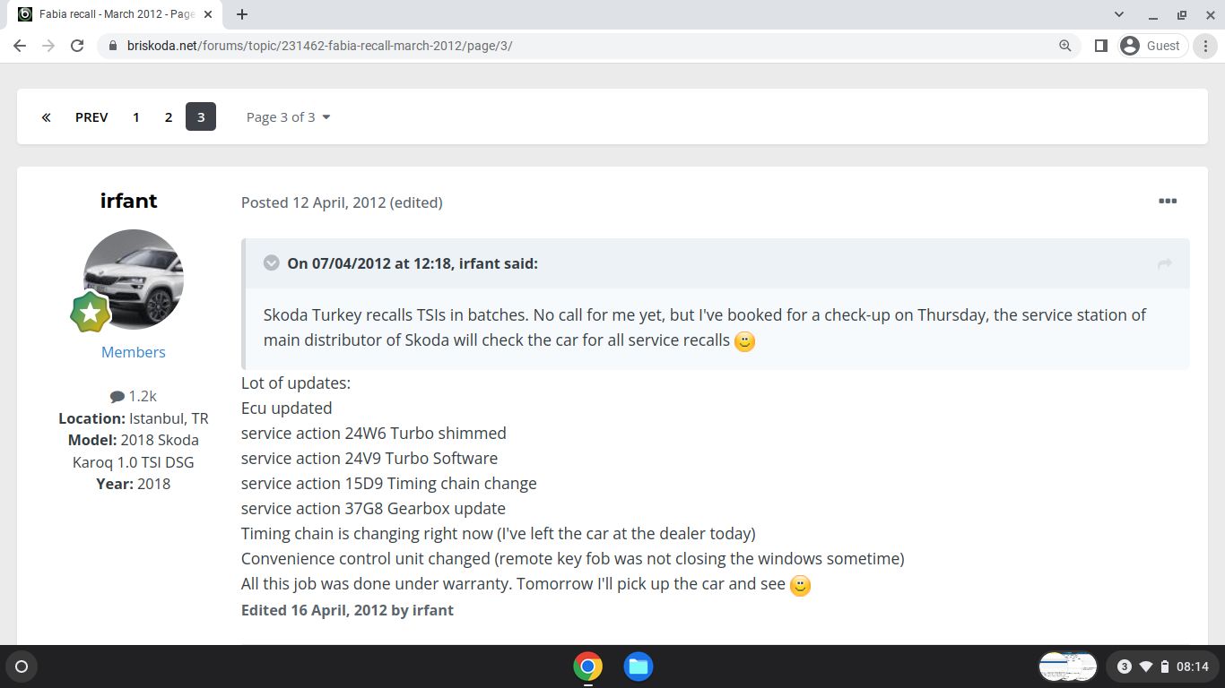

Hi 37G8 recall was conducted so I (assume) that the gearbox oil is mineral? Would it hurt to have a service and make sure the correct oil is there?
Thanks
When was that done?
The Global Recall was on 2009-2012 DQ200 DSG,s and that was '34H7'.  Pre late 2012 cars.
Does your gearbox work ok?
Up to you if you want to have the DSG serviced.

The update (software) I think was done in July 13. Gearbox works fine. ,
