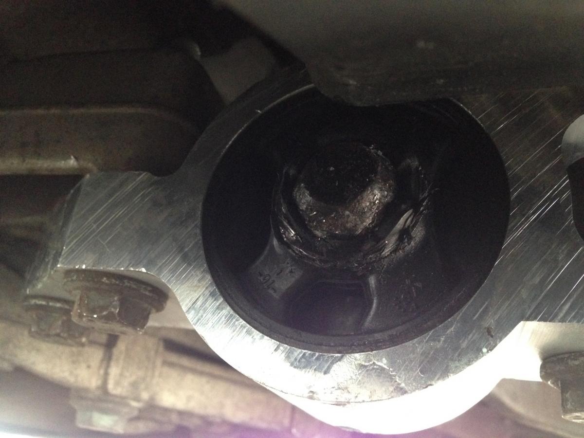

Perhaps a silly question I have just replaced my front right wishbone control arm bush, now it did seem to be a really tight fit and the rubber seemed to get squeezed out where the wishbone plug has gone in. Now I have bought this was from GFS http://www.gsfcarparts.com/423vg0540 and was wondering the if the right hand side means where you are sitting inside the car or if you are in front of the vehicle? The gusy at GFS told me when you're sitting inside the car, but my local mechaninc had issues getting it in and now you can see the metal sleeve where he's been trying to hammer it in with a socket and a hammer.
The car is going in for a MOT at noon so a bit worried about the whole thing.

I meant the wishbone shaft it doesn't look good like the other side the rubber around the metal sleeve is sticking out where he was hammering it in to me it looks like a bodge job, we shall see what the MOT guys will have to say. He did use hand wash liquid soap to give it some lube but I still have concerns.
sounds like he has damaged it from the hammering, it should slide on easily with lube such as ky or washing up liquid
It passed!
However I don't like the look of that

The rubber on these is very hard, I do not think it will deform. It may be just a bit of excess rubber pushed out.

Arthur: Yeah, that would annoy me too. looks like maybe the shaft could have been cleaner?

I know it passed the MOT however the guy who owns the garage would never do that he has few people who work for him and they are careless when it comes to doing a decent job by the looks of things, it does annoy me when someone doesn't know how to put things together properly that is all. Parts should usually fit together I know sometimes brute force is required however by not damaging new parts altogether.
He should have given a scratch with a metal brush or little sand paper polish
