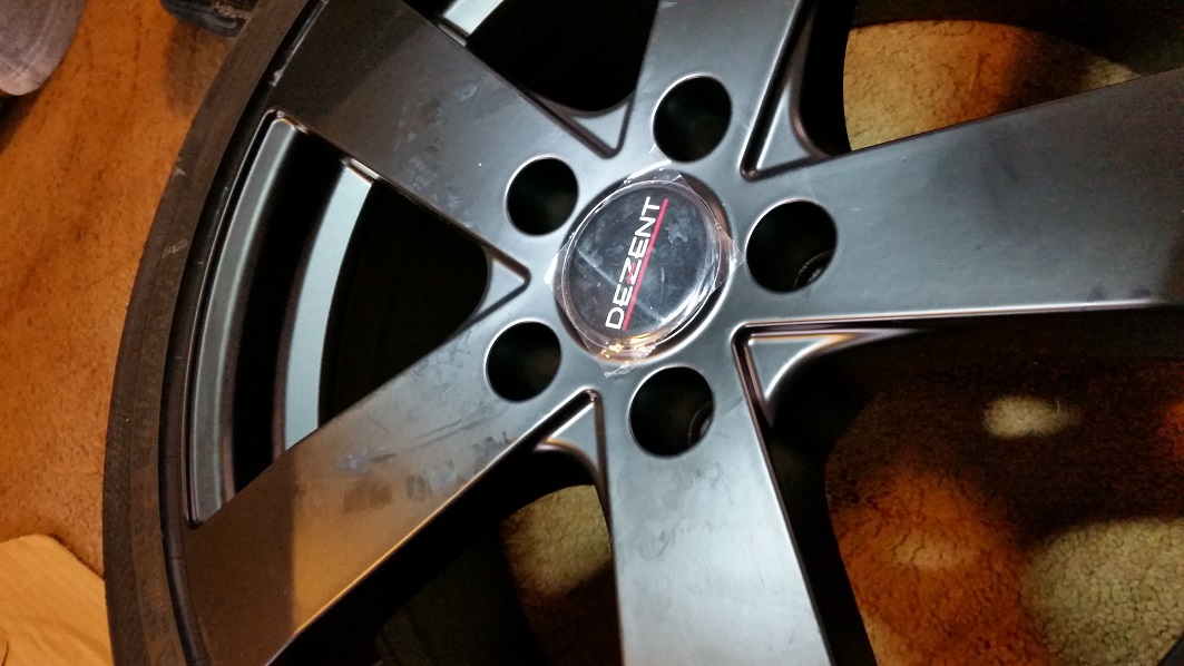

Just a quick one, I've had some wheels shipped and in delivery they have been marked. They are a matt type finish and it looks like oily marks (see pictures)
I've tried cleaning one with an alloy wheel cleaner and car wash soap, but either has done anything to remove the marks.
Any ideas?

GT85 ( or wd40 ) on kitchen roll is best for oily marks , non abrasive too

If its oil it will come straight off with Gt85, if not id send back

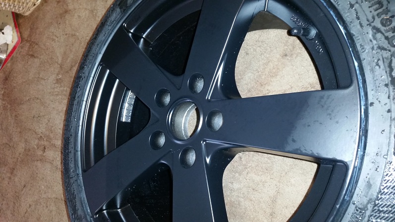

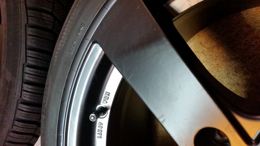

Here are a few more pictures of the wheels.

Probably transport tape..WD40 will be fine
Personally if it is, I would use some AS Tardis to remove it

Looked at them tonight and the mark came back after.
So I tried some sticky stuff remover and it's gone again.
I will see what that alloy is like tomorrow .
Just to update and thank all for the suggestions.
Sticky stuff remover worked a treat taking off the transport marks, and the company refunded £40 to me.
