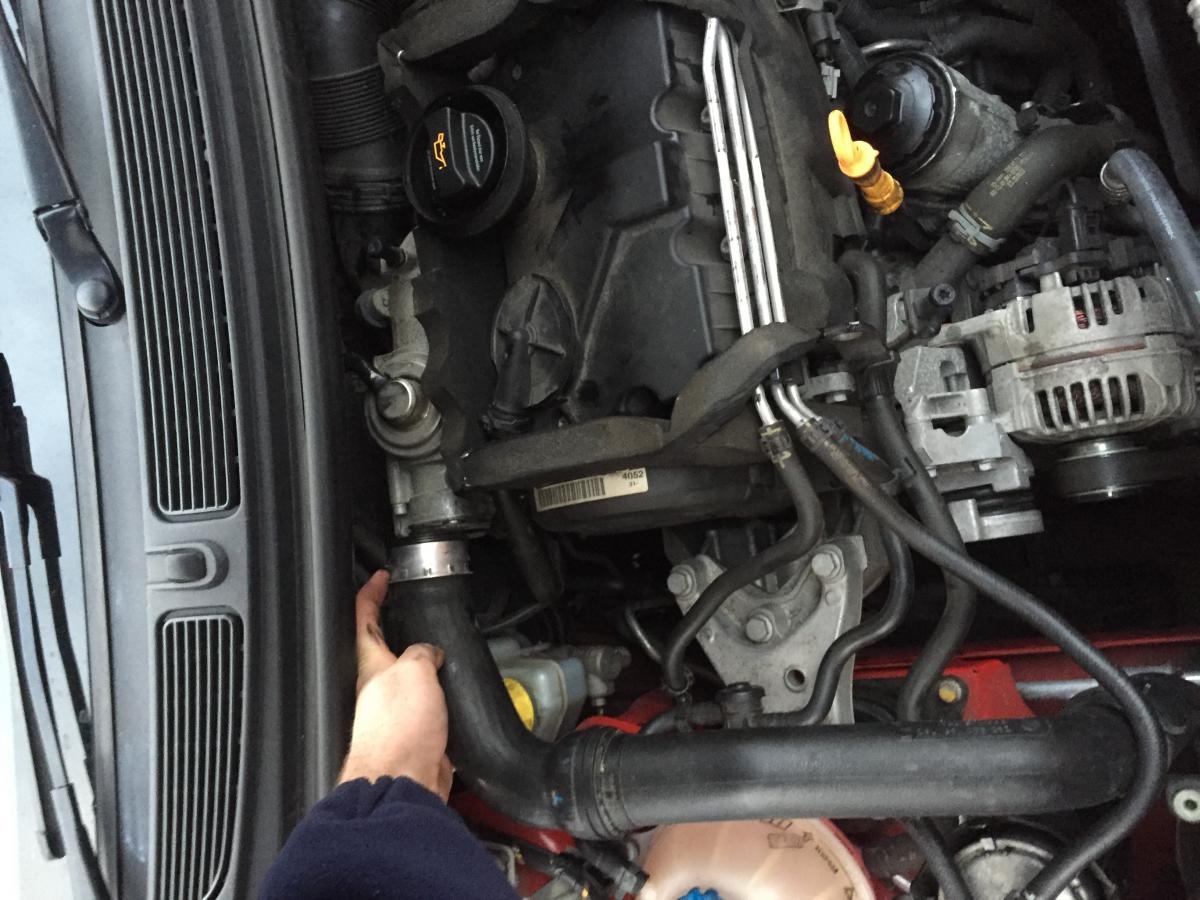

Was servicing the car and noticed a hose wasn't in place properly, I pushed it in seemed to be in firm, but it blows out again at 2.7k rpm!
I will try to post a pic in a min, but it's the silicone pipe that goes to what looks like the EGR at the back of the engine at the top.

It's the silicone one I'm holding that's broke, I can see the metal fitting by my finger has worn out on the retaining clip so that's why it pops !
Right I've found one on eBay, after a fruitless day at local scrapyards! For everyone's reference the part number of the hose is 6Q0145838H and the hose clip is 1J0145769F
