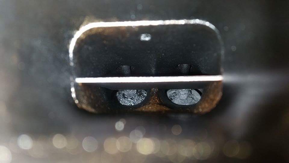

The biggest problem with these engines are the carbon deposits on the intake valves, they look horrendous from as early as 40K. It will eventually get to the point where you need to take the cylinder head off and do a thorough cleaning of everything.
The photo shows just how bad they look on a 60K km car that redlines quite often actually.
There is a nice product from Tunap that you spray directly into the intake hose iirc and helps with those deposits but it's only effective if you're doing it from the beginning of the life of the car and on a regular basis of 8-10K.
Whos valves.
& having been run with what oil and what fuel and with what map on what engine.
Was that your engine at only 37,000 miles ?
We have pictures of 1.4 TSI CAVE engines with valves burnt out, especially 2010/11 built engines.
But that still does not lead one to believe that there is a need for using a carbon cleaner.
Unfortunately there is indeed such a need after some mileage. Don't know the owner in person but it's a 2011 CAVE, no idea about what oil and fuel he's been using but given that he's tuned the car and generally taken good care of it I assume they are not relevant. I've seen similar pictures from others that have had the engine opened either for uprated pistons and rods or just rebuilding due to high mileage and they are more or less the same. It is not something you easily notice until it becomes much worse.
Mines looked almost like that photo when I saw them last week, more on that later...
Interested to hear more about that!
Tried getting a photo of the valves but the damn camera just wouldn't focus properly so they all ended up too dark and got deleted.
Let's just say you should be careful when using a torque wrench at the lowest part of its range (ie: don't use it there) or ugly things can happen...
