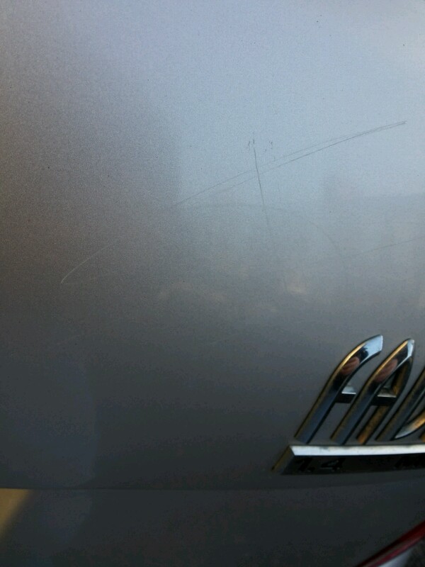

Got home to find my car has been scratched... Alot.
They aren't deep scratches and i'm wondering what the best way to get rid of them is?
Any suggestions?
The car is silver if that matters.

If the scratches are not deep (I tend to use the finger nail test - If nail catches it's usually too deep) if it doesn't catch.. G3 professional do a kit in halfords which consists of a scratch removal liquid and 2 (black & white) waffle applicators. I've taken some light and deeper scratches out with that.
Worst case scenario it would be a a wet sand and polish up using a machine polisher and adequate compounds to fully remove.
Hope this helps. Any more questions fire away :)
Karl.

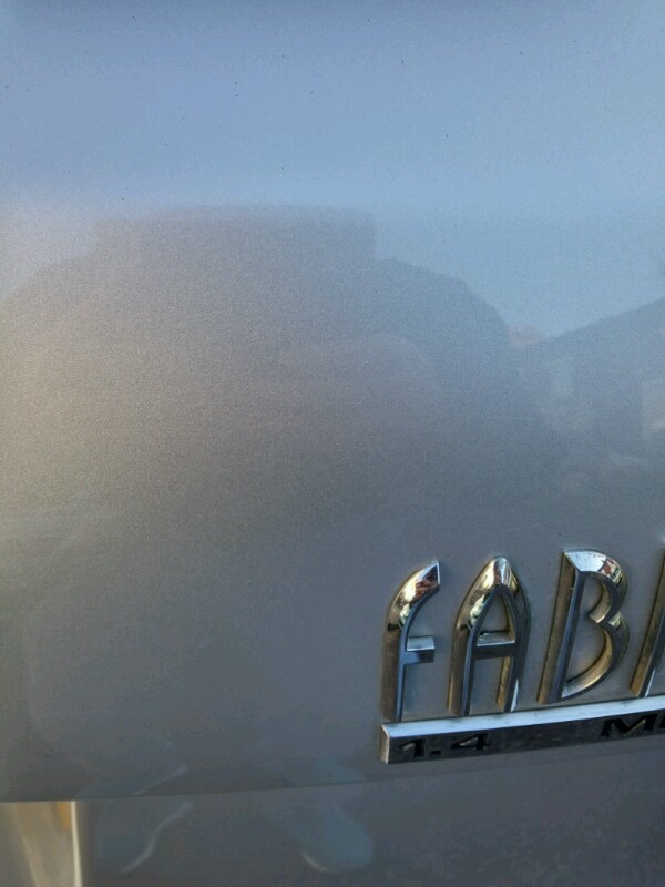

A before and after shot...
Pretty good stuff.
Used G3 scratch remover paste and liquid.

Great advice. Worked a treat.
