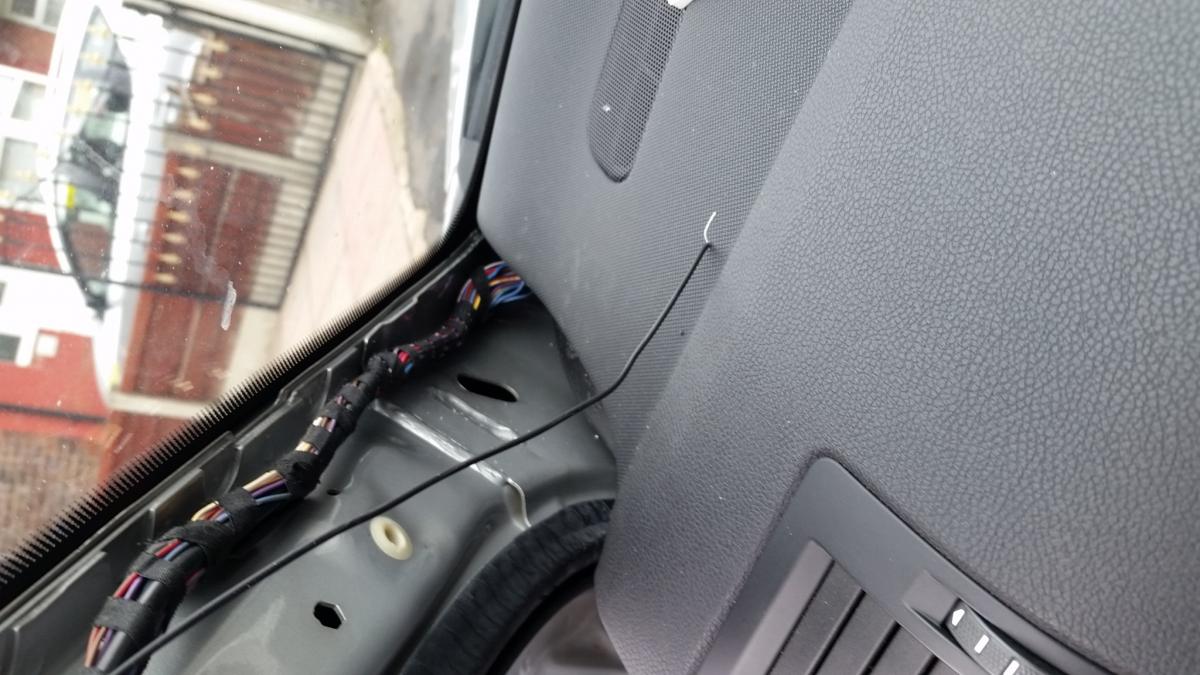

Never got round to really have a look at the problem but while I was doing something else I came along this snapped wire behind the passenger side windscreen pillar. It goes towards the rear end of the car through the roof lining. Cant seem to see where it was connected to.
Does anyone know if this is a wire for rear demister?

Could have come loose from the rest of the loom.  If you can, trace the cables back and look for any empty connectors. There'll be a wiring diagram around somewhere, or if you have access to the octavia haynes (diesel only, but I'd assume the wiring at this level is identical) it'll have it in there.

That wire looks a coaxial cable as used for a microphone. Is it a black covering over a copper braid over a white foam plastic with a wire in the centre?
If so the previous owner probably just cut or pulled out the rest of the cable with the microphone when taking out his hands free system.
Likely it went up the pillar and then across to the interior lights area.
