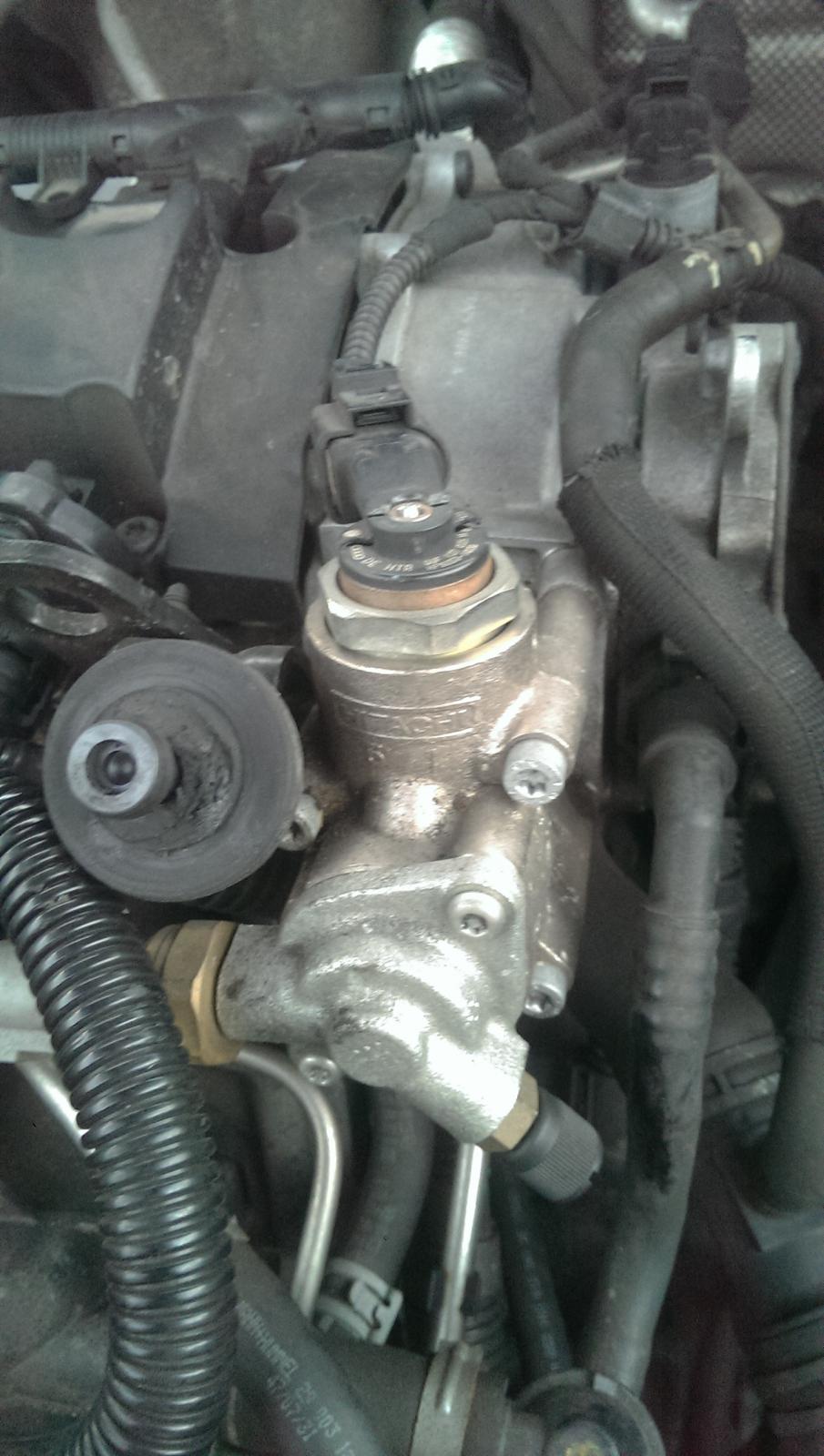

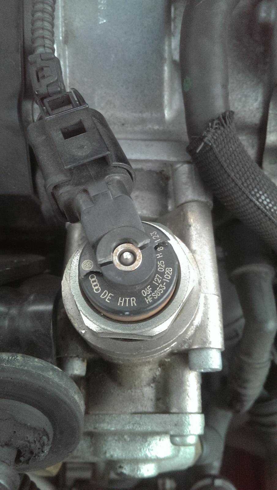

I reckon this is the problem.
My air filter/ engineering cover is always loose. All the rubber mounts have snapped or corroded away so that's bounced onto this sensor and snapped it I think.
Is this part the fuel pressure sensor? Or regulator?
Can I replace just the sensor part and not the whole thing?
Cheers
