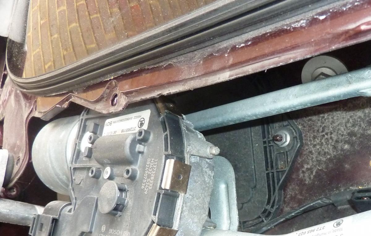

...Not sure if this picture helps.
This is the driver's side after the trim has gone.

Thanks for the picture that does help. since i started the thread i poured water down the windscreen so it would go in the trough under the windscreen plastics and waited.
The water poured out from behind the inner wheel arches, which is fine, that's what i want it to do.
That still doesn't tell me where it's coming in, but it's not done it since.
