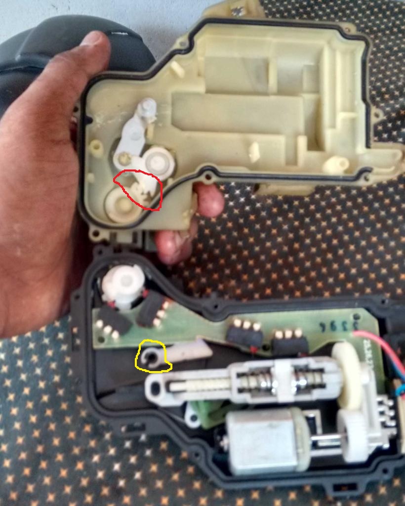

To give my small contribution.
Few days ago the lock on drivers door of my started to make troubles. All doors would lock except drivers door. So I took the lock mechanism out and when I disassembled it I found the following issue. On the photo you can find attached, one part of the plastic in yellow circle got broken and it got stuck between plastics in the red circle jamming the door lock and not allowing it to unlock. I fixed it by removing the broken part and reattaching the rest of broken plastic to its holder by very small cable tie so it could move and be attached at the same time.
