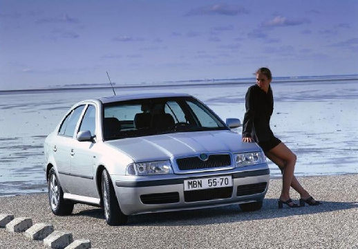

I think that's a MkI you have there, albeit a very late one?
The shape of the sill looks more like a MkI than a MkII.
The shape of the holes in the steel wheel also suggests MkI too?
The MkII was introduced in 2004 but the MkI was kept on sale for several years after to cater for the die hard taxi driver fraternity.
Welcome back to the Skoda fold though  :thumbup:
MkI...
MkII...
Edited by silver1011
You have a keen eye silver1011 and thanks for the welcome. That photo top is indeed mine, a MK1 (1U2).
