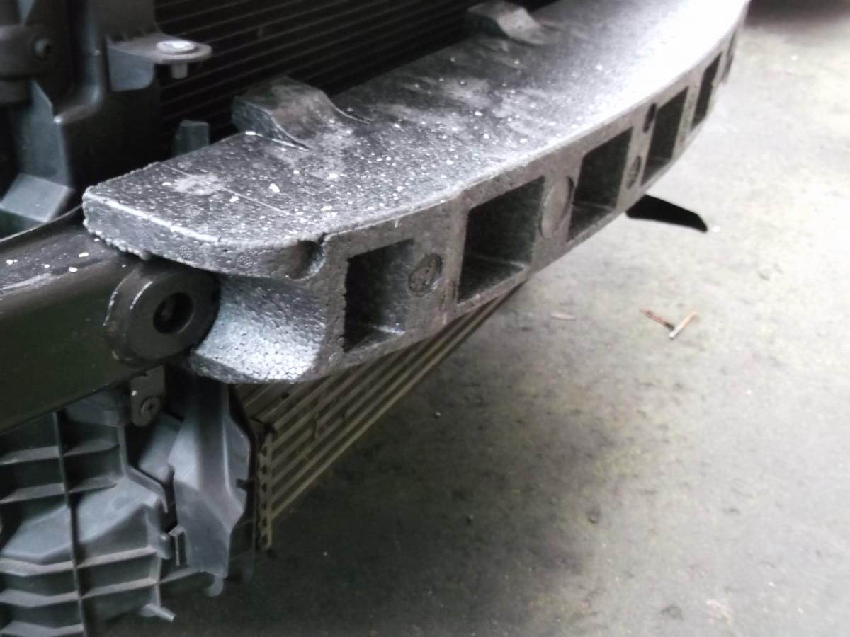

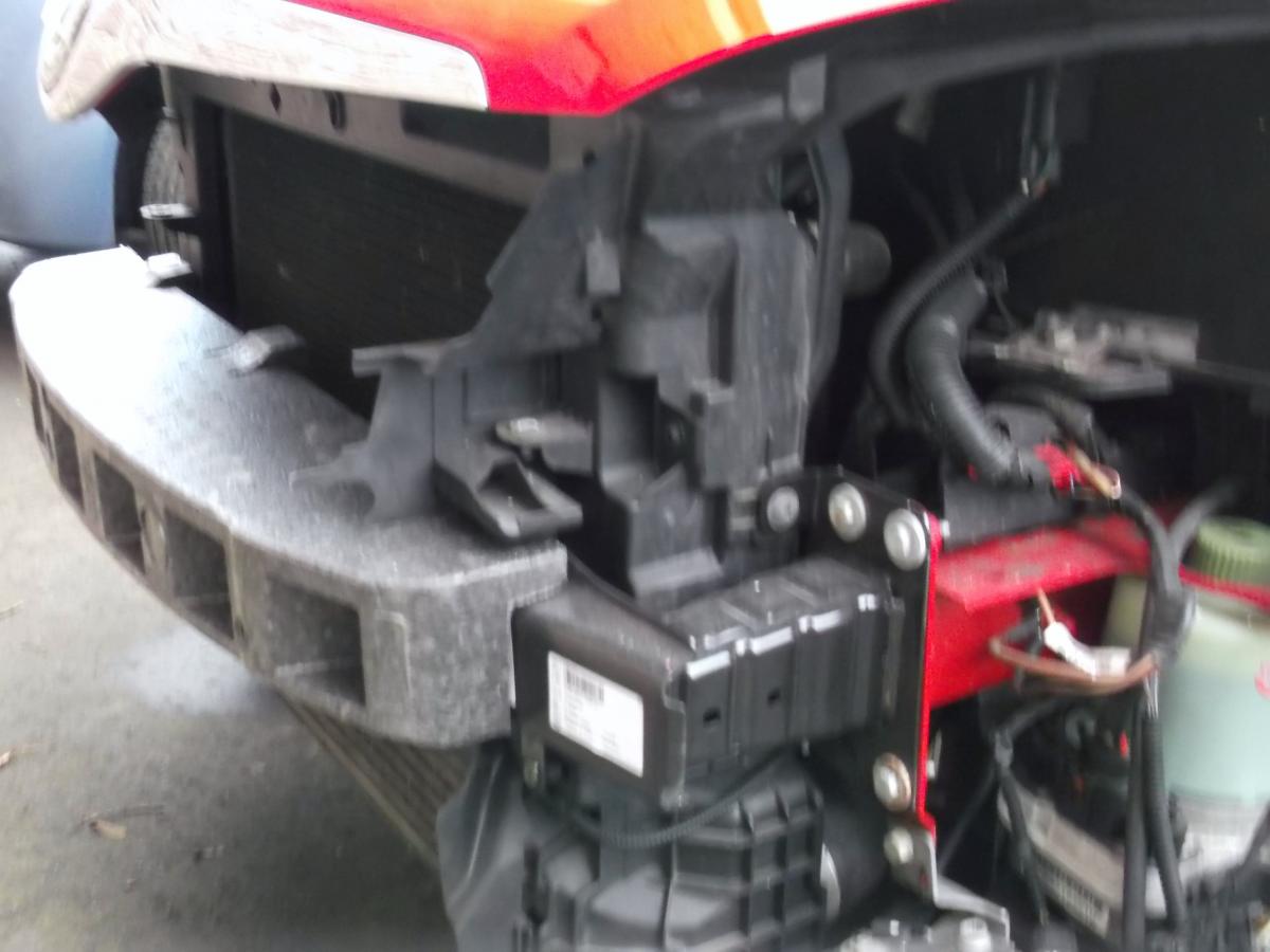

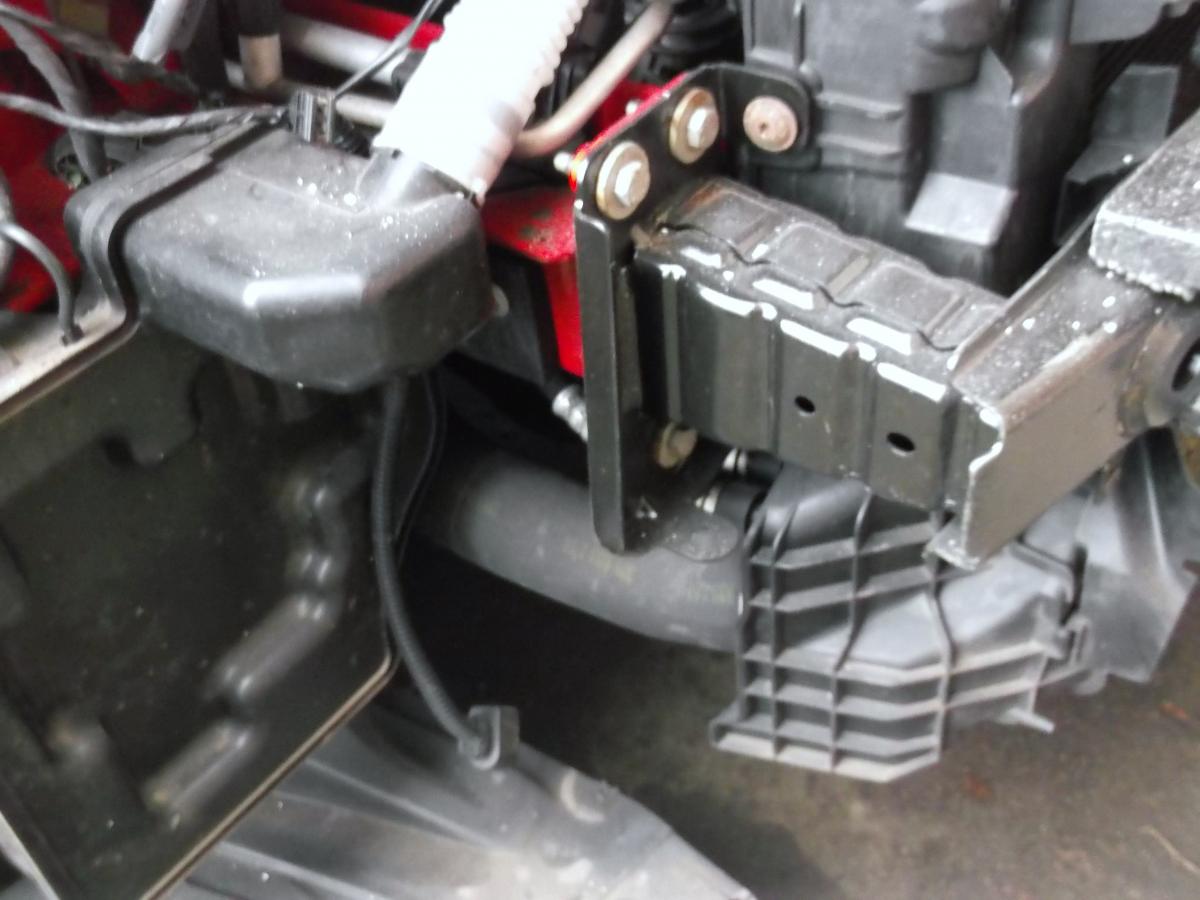

Jeepers ... looks like a lot of plastic mouldings in there -- how does this stuff get 5 star NCAP ?
Hope they haven't got a "defeat device" for that as well !!!
This is a Mk2's crash protection, but just the same.  Does the job at low speeds at least, but all still needs replaced usually, even from a low speed collision.
