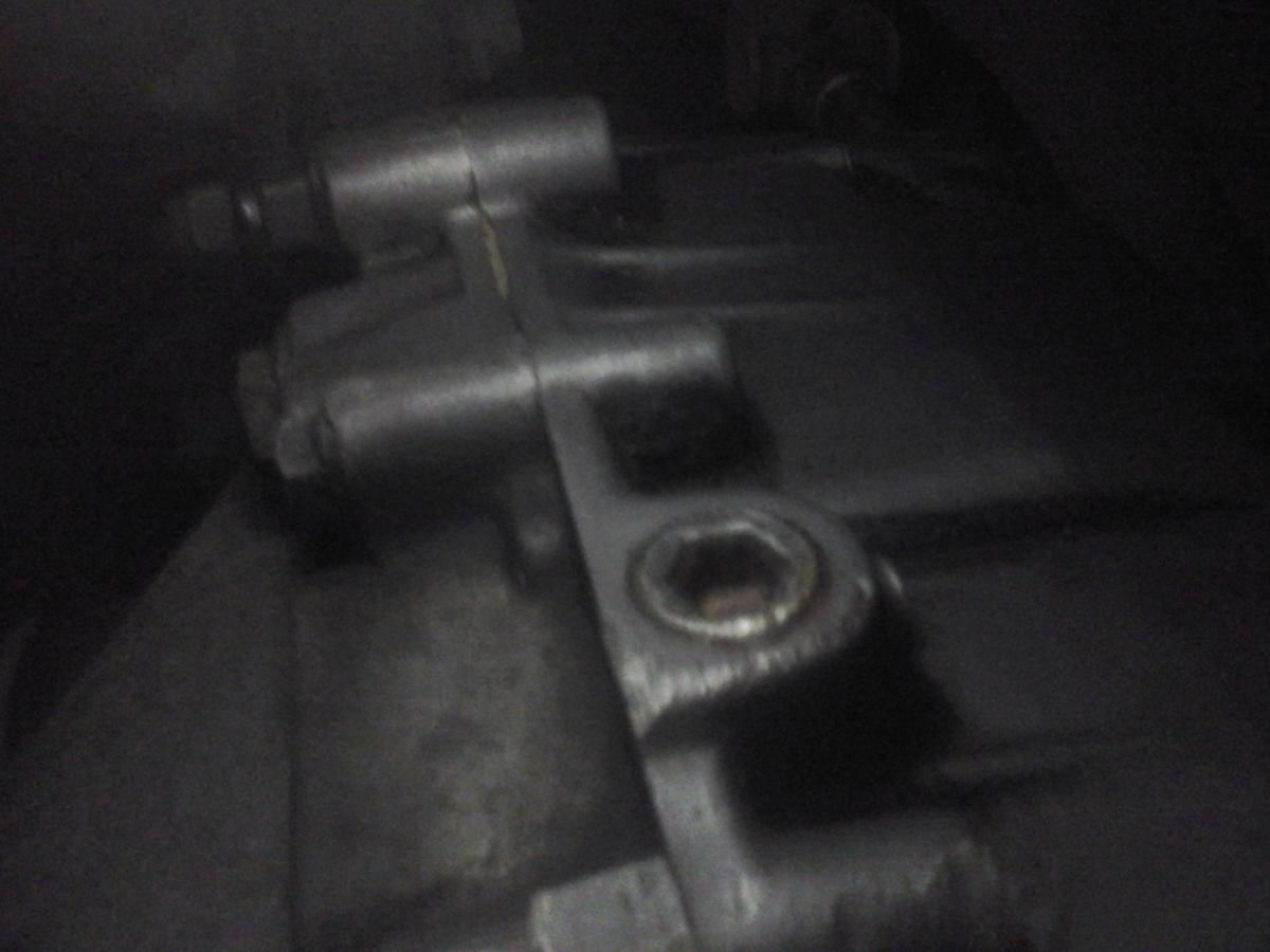

what is this bolt on the bottom of my felicia 1.3 gearbox for ? its strange, its different from the one you unbolt to change the gearbox oil. thankspost-114994-0-80903600-1448998271_thumb.jpgpost-114994-0-80903600-1448998271_thumb.jpg
That is a sealing plug. One part of inner shift selector fork is inserted through that bottom hole when the gearbox is assembled. The hole is then sealed with that threaded plug.
