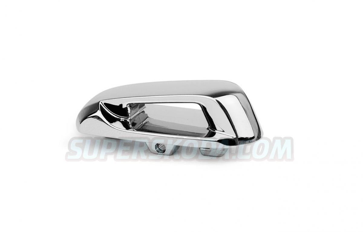

While browsing the Superskoda web site, I cam across the Octavia Key Mod, the link for this is, http://www.superskoda.com/Skoda/OCTAVIA-III/Octavia-III-original-Skoda-key-bottom-chrome-endtip-RS6-style, I wondered if this Chrome end would fit the Superb Key Fob, just a shame that Skoda don't  give all the Superb's which is their top model, this as standard.
