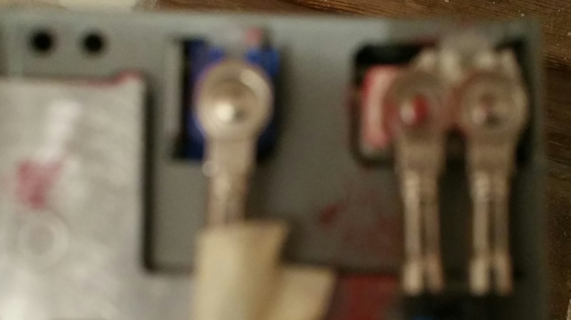

Hı,  I'm hoping to fit an rns 310 amundsen into fabia mks. This is picture of rear of unit. I presume the 2 wires on right are for satellite antena but what is the left wire for ? As it's been cut off.
The two on the right are for the radio signal, one comes from the windscreen aerial and other is from the roof aerial.
the one on the left is the GPS aerial.
