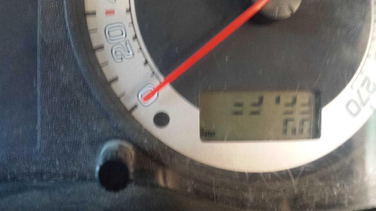

Whats is wrong with my speedo ?
The two displays in the instrumental cluster have managed to get the digits faded . They however work absolutely perfectly with all the needles working as they should .
Is this repairable also I have known the clusters cannot be just swapped over as they require coding.
Could probably be opened up and have that screen replaced with one out of a working cluster. The vRS clusters normally only sell for £15-£20 from breakers in my experience.
so this isn't a circuit failure my displays just have to be replaced?
