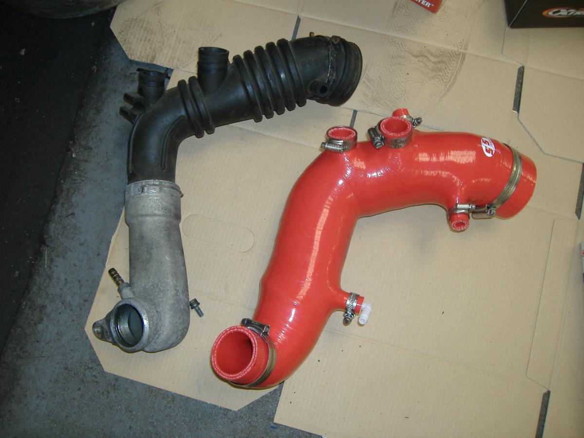

The SFS one is the one you want. I had a standard intake pipe with a bigger Neuspeed metal elbow between the rubber pipe and the turbo and even then the SFS oversized pipe is still massive compared to it.

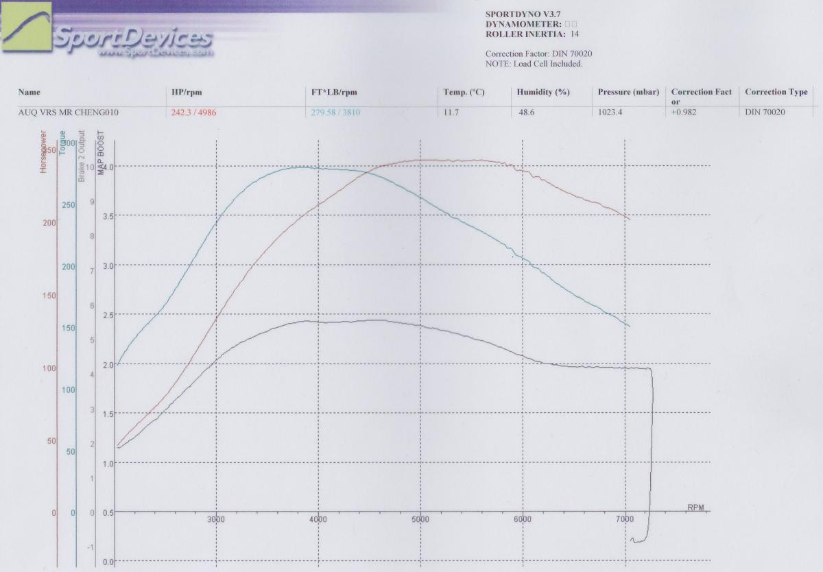

It did hit 293lbft at one point, but this is the best bhp it made. I've left it alone for now as it is plenty of power for me, especially in winter.

You can see from the graph. It peaks at 1.5 bar and holds 1 bar until the redline, although it's a little less than 1 bar at the very top as it made no difference in power with a standard K03S turbo.
