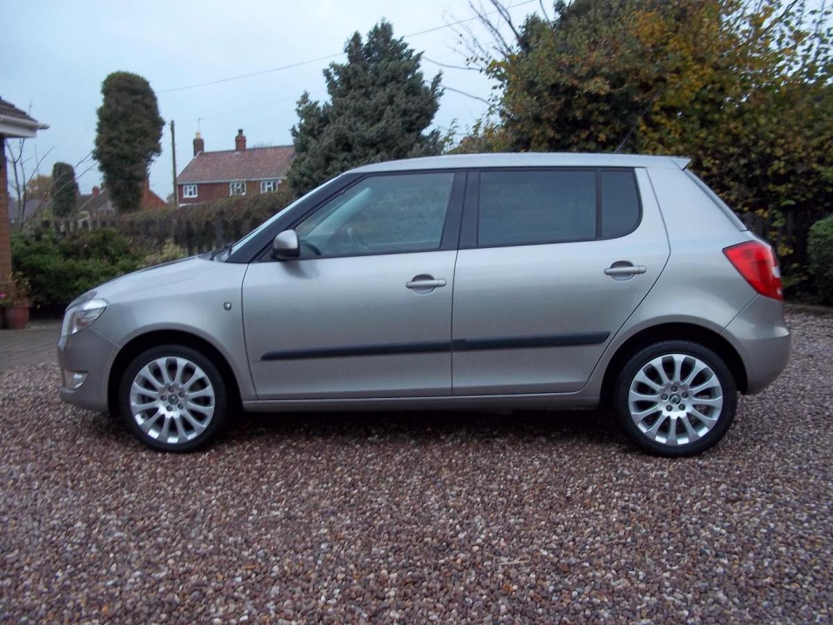

Which 16's are they?
Are they the ones with 5 sets of 2 spokes? If you know whet i mean?
Pic
