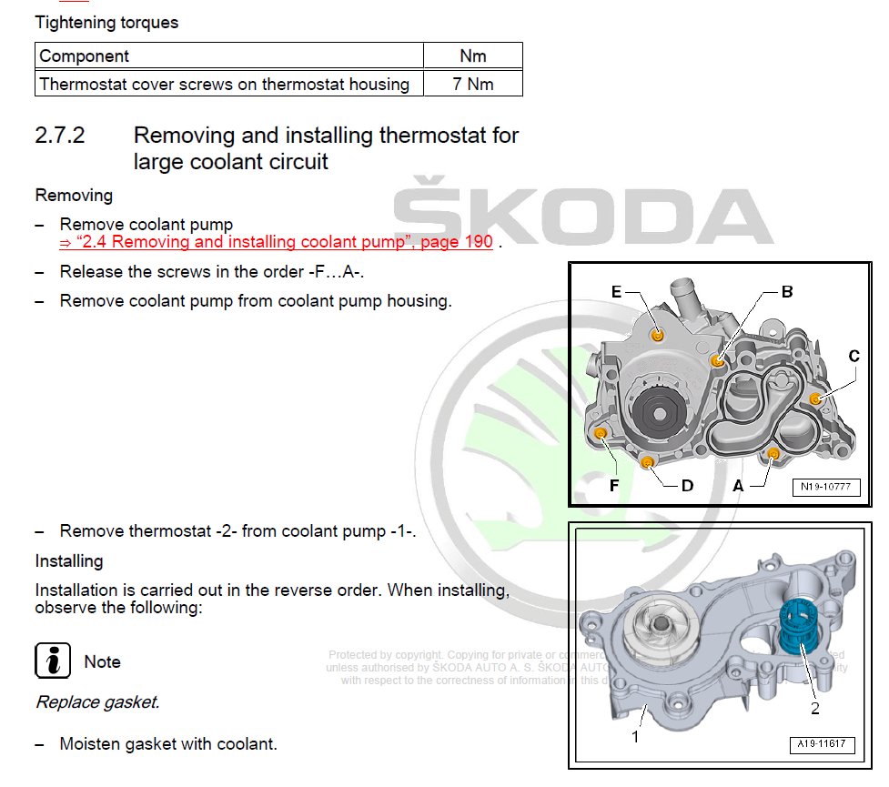

I'm trying to find out how much they are and how easy to replace,
Looks like there are 2, one on the main circuit which I take is the block and the other on the head.
None easy but it sounds like your heater is working so the head one should be OK.
This shows the main circuit thermostat and there is a bit of dismantling before even getting to here.

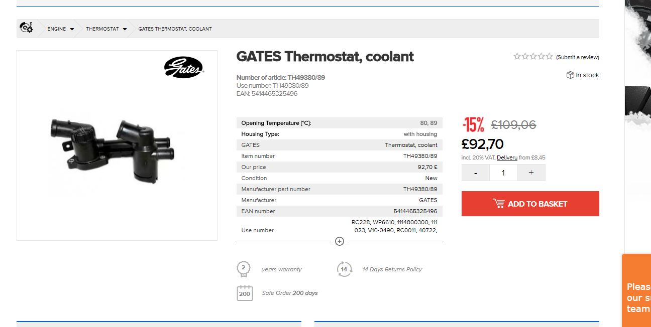

Thanks for that, however the only part I can find when I do a search for a 1.2 TSI thermostat is this type. No one list a thermostat in the coolant pump housing!!!!
Could that be a difference between the earlier and later 1.2 engine?
Possibly, that's what I was thinking.
