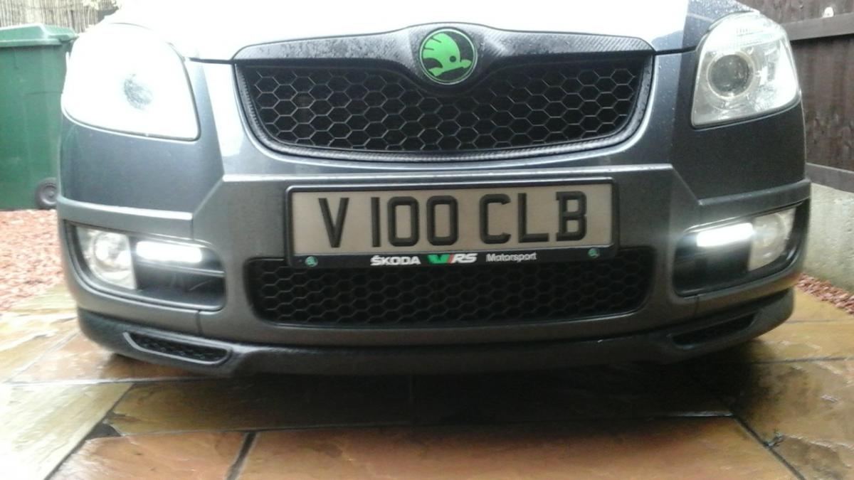

Hi, I fitted some Philips LED'S just recently, they link up to the side lights and go out when you switch your lights on.
They are a very well made light. The only thing I would say about these is this, the lights themselves click into a mounting bracket, make sure you have everything working, and in the right place before you click the lights into the brackets, it is "almost" impossible to get them out again.
Apart from that, there good lights. :nerd:

Hi Andy,had a real job uploading pic's, I've never had prob's before.
I fitted mine next to the fog lights, as you can see.
There's no real way of taking a picture to show how there fitted.
The bracket on the lights allow you to fit bolts upward and backwards.
I fitted my first set of DRL's into the front grill, was a lot easier.
The lights themselves,they link through a box between the battery and side lights.

Hi Andy, the box I mentioned does all the switching on and off, no looking for spare fuses or wiring up to ignition etc.

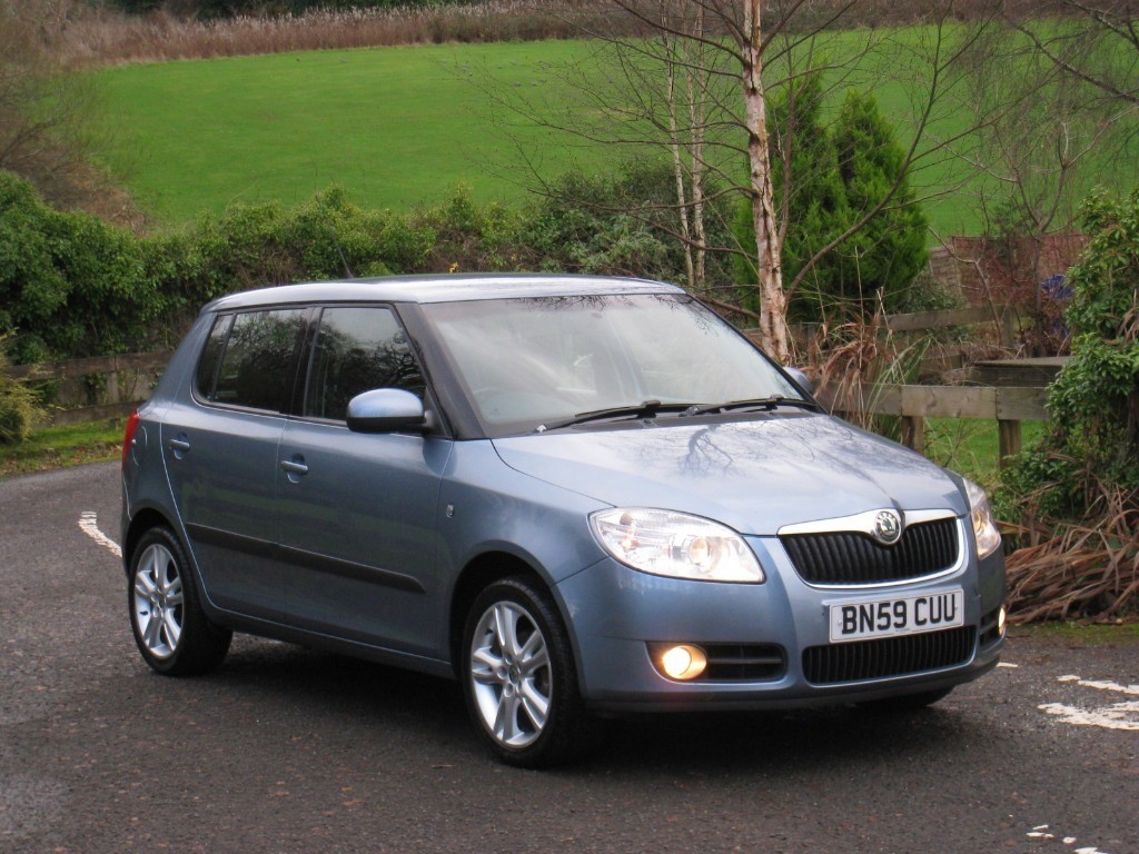

2009/59 SKODA FABIA 3 1.4 TDI 80 **1 YEAR MOT - JUST ...

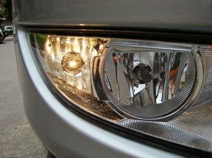

The Fabia above has it's front fog lights turned on. It is possible to set these to operate as DRL's but at a lower intensity.

Hi Silver1011,
The Fabia is on picture 1. We do not have the switch in the fuse board or the wiring in place - or if it is in place, I missed it. I am I did think about connecting to clamp 56b as on Elsawin wiring diagrams for the MY2009, but I am going to utilise clamp 61 now which switches the fog lights (DRLs) on when the engine is running. I am going to use a relay and tap into the fog light wire via a fuse.

If the first photo from my previous post is the set-up of your Fabia then the cleanest and most OEM look will be to utilise the front fog lights to perform the role of DRL.
If it is possible on the Fabia then you'll need VCDS or perhaps even Carista to adjust the coding.
I used VCDS to set the front fog lights as DRL's running at 60% brightness on my 2008 Octavia...
