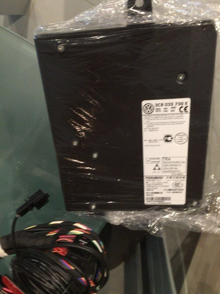

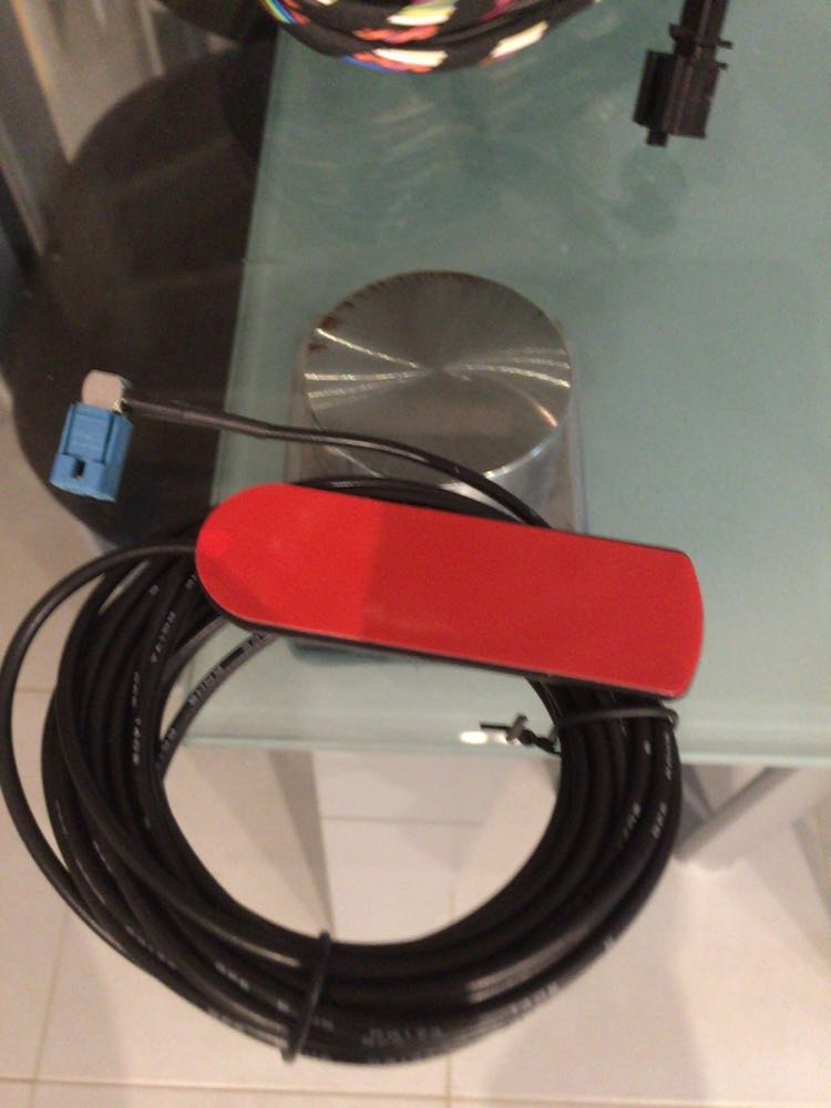

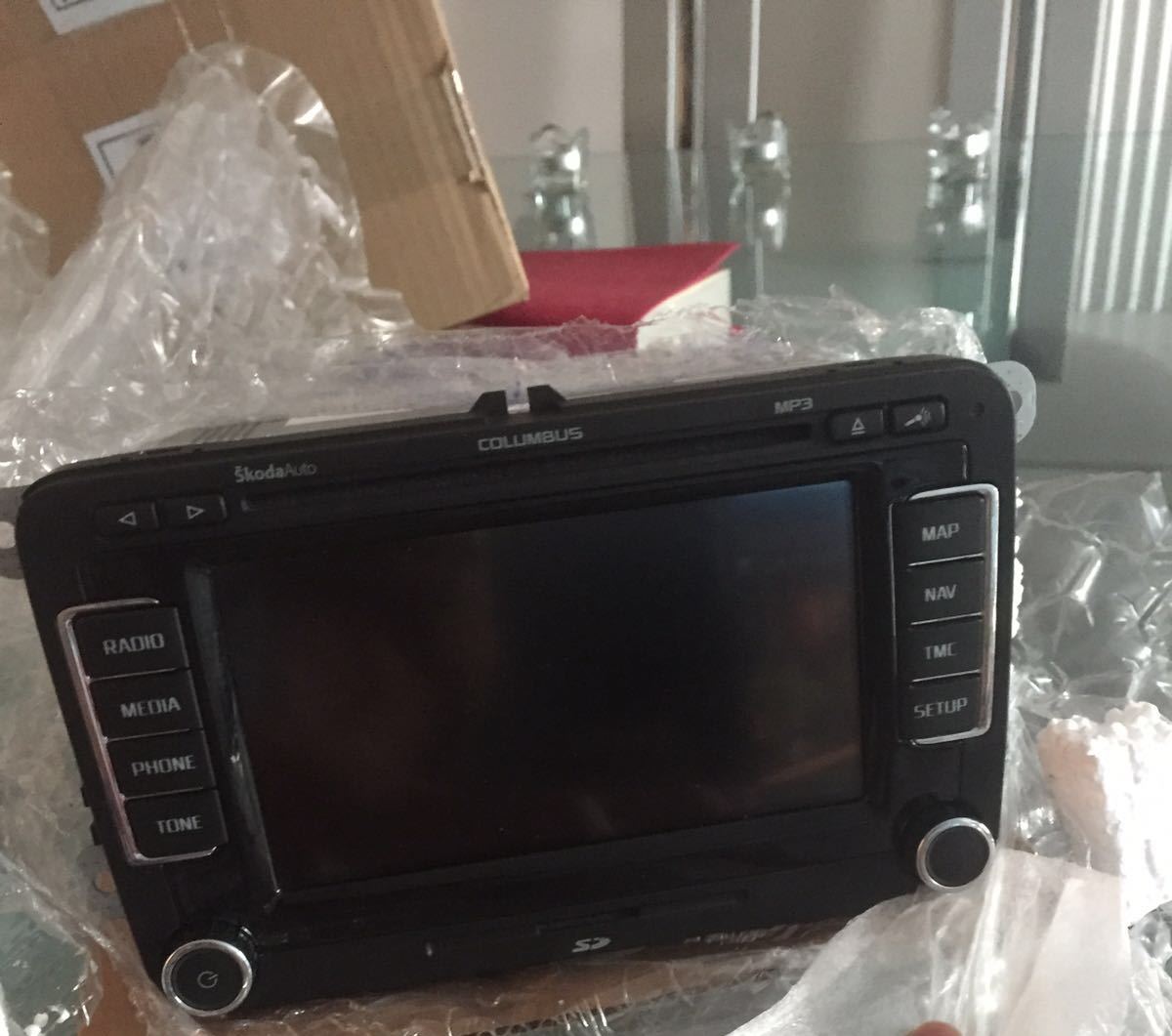

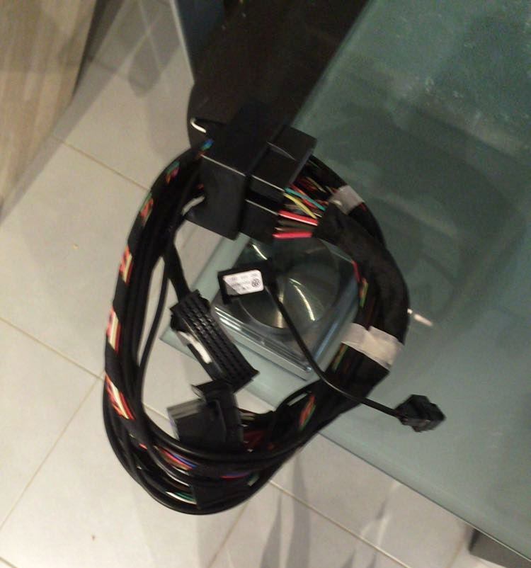

Her is new Columbus and BT and cabling arriving today. What do you think?
