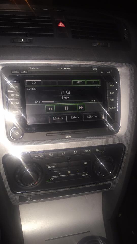

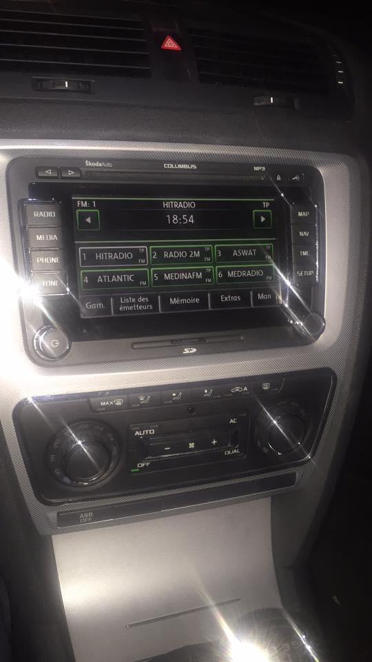

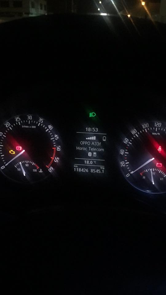

Hi I have tried to enable rSAP with Samsung Note and it work fine and i can enable Wifi on Maxidot.  Now i will try to root my Oppo Neo 7 to enable rSAP.
JUST TO KNOW, No need to use VCDS for Otavia II FL with Maxidot.
Thanks for help
Good to know it's all working.
VCDS will still be required in some cases, in your case the BT module is probably close to the correct coding but it might not be perfect. Others may not be so lucky :)
Hello,
I confirm that for Hotspot WIFI on the BT MODULE 3C8 035 730 E, the phone should be compatible rSAP. The BT show on maxidot the WIFI option and then it activate the 3G connection through the phone.
