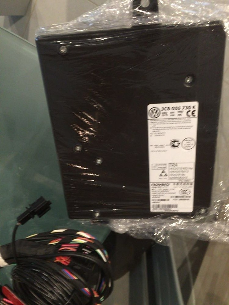

I m looking to buy the BLUETOOTH KIT WI-FI HOT SPOT MODULE 3C8 035 730 E for My octavia II FL 2012 with maxidot. and need a confirmation if this moduel will reorganized plug and play with RNS Columbus 3T0035680K and my Mixdot or i need to do some coding in the CAN Bus.

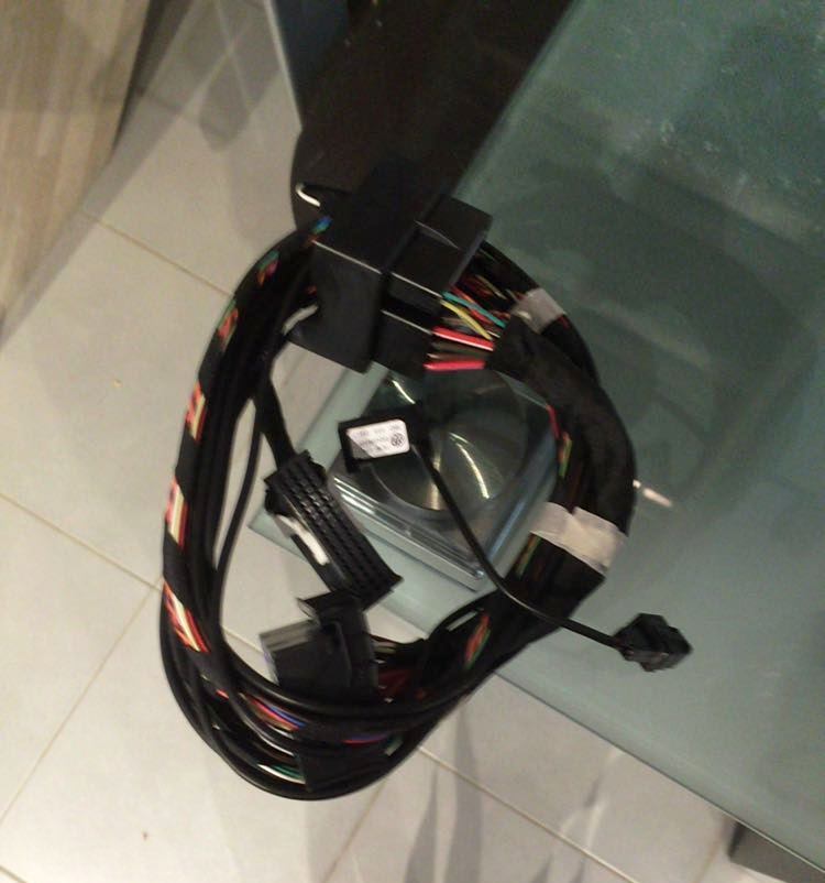

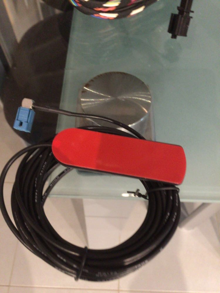

I have just receive my new BT module with cables and GSM antenna. any one has already install the same module in Octavia II Facelift?

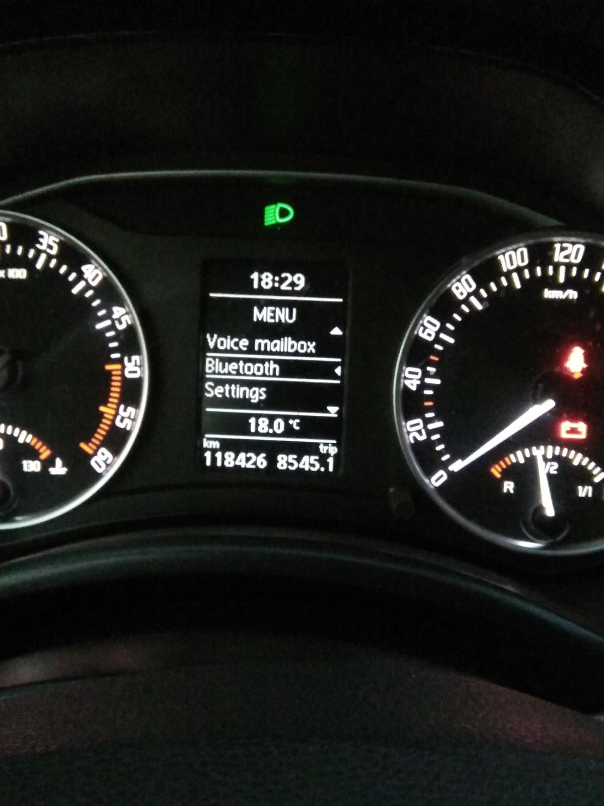

Finally installed my columbus and bt are totally integrated with maxidot.
The only issue is i can t locat where to enable the wifi hotspot?
Any idea??

no coding was maded. BT is plug and play installed on my maxidot and columbus.
I have tested with iphone 6 and OPPO Neo7.
This is the only option missed on this installation. all of the rest work fine.
