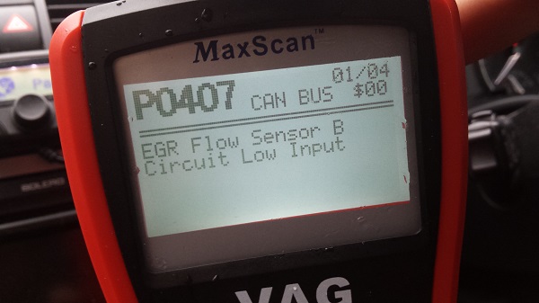

How do you know it is the EGR or DPF?
The flashing glowplug light is used to represent literally hundreds of potential faults.
You really need to get the car scanned for fault codes before assuming a EGR / DPF delete will fix your issues.

P0407 is the code : see readout below.
Cancelling the code and driving about 50 miles the light (glowplug flashing & EM light stayed off)
- it came on once then when cancelled again it has gone off & stayed off so far
-did the snake oil work and just take a bit longer to work its magic?
-will the light come back on again?
-should I still be thinking about EGR deletion long term?
