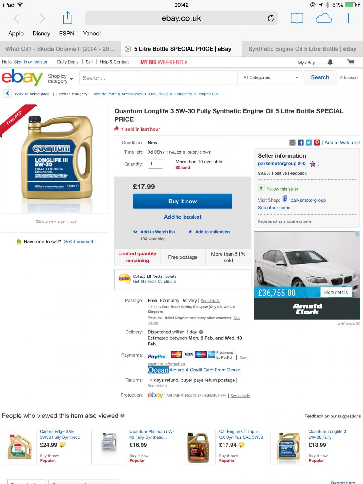

That's it there and it's Parks of Hamilton Townhead Garage in Hamilton ....

It's dropped another pound overnight, now £17.99!

Am I right in saying the Gold one in the first link is suitable for the CR 170? Sorry if it's Rhetorical. I have about 3500K before my service is due (fixed major) and might buy this as a friend of mine has pointed me in the direction of an Indy centre who charges way less than the dealership. Might give them a call and see if they'll accept me supplying the oil.
Worth a try eh?
Edited by LordRaiden84
Yes, you need the gold one.
Your CR170 has a DPF (Diesel Particulate Filter) so you must run oil that meets the VW 507.00 spec (basically the highest spec oil Skoda use), regardless of which service intervals you are on.
At £18 for 5 litres you really can't go wrong. It won't stay this cheap for long, buy now whilst you can!
