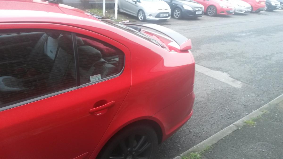

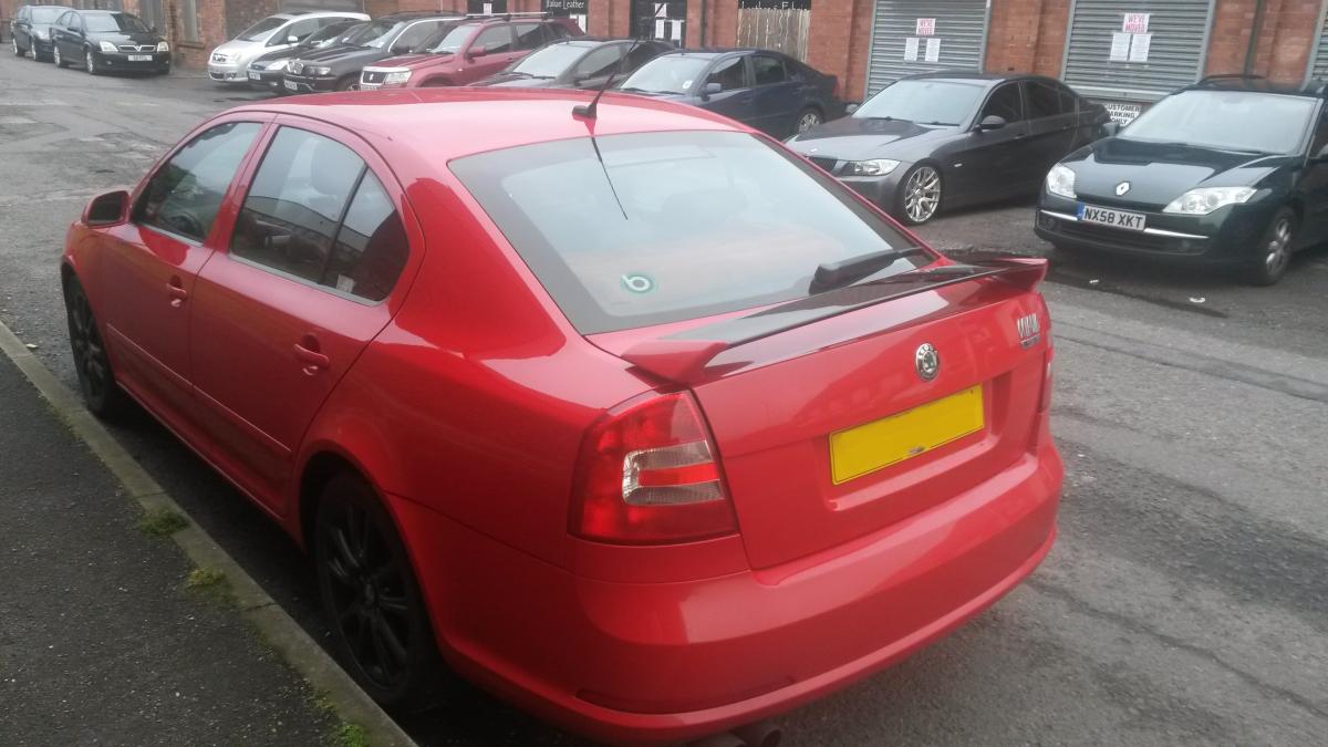

Well finally got round to getting it done. Decided to just paint the middle flat part of the spoiler Black it would have looked too much I think to do the whole spoiler. I like it, matches the wheels and grille now. Once I get chance to clean the car and its in a better position I will take some proper shots. Going to start a build thread I think changed quite a bit now and want to keep track in a single thread rather than lots of separate posts. They were the correct bolts so thanks for the help.
