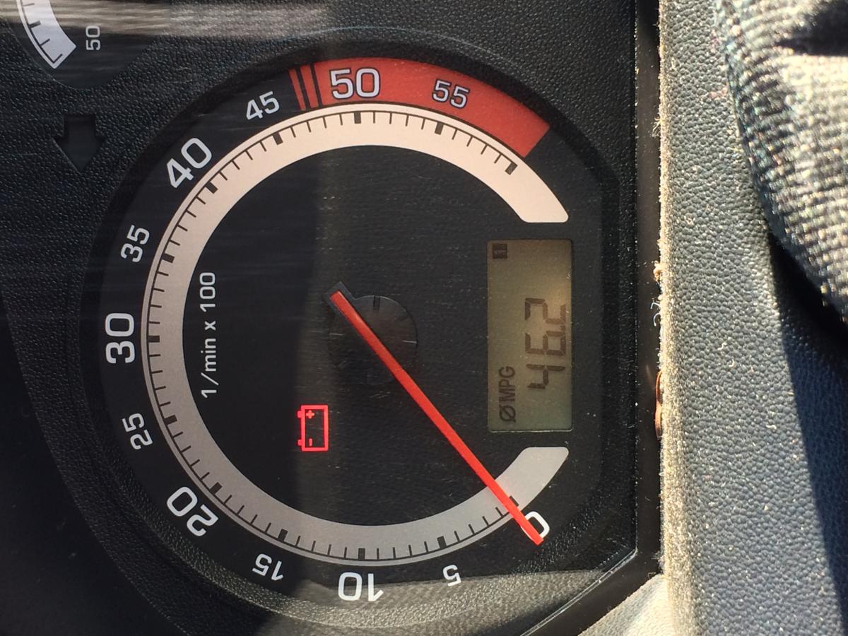

Just gone 140 miles round trip to pick up a milltek system and I end up with 46MPG and that was loads of gear 5-6 cruising.
Driving around I usually get like 32-34 as well, seems I'm like 10mpg lower than people.

Don't trust the mpg reading - can be pessimistic as well as optimistic (my Superb I under read by 4 mpg). Measure full tank to full tank or if you are as sad as me use something like Spiritmonitor (click on the link in my signature below) or Fuelly

I think his problem is more, everyone els with the same car is reading higher than his.
Could be a faulty air flow meter.
