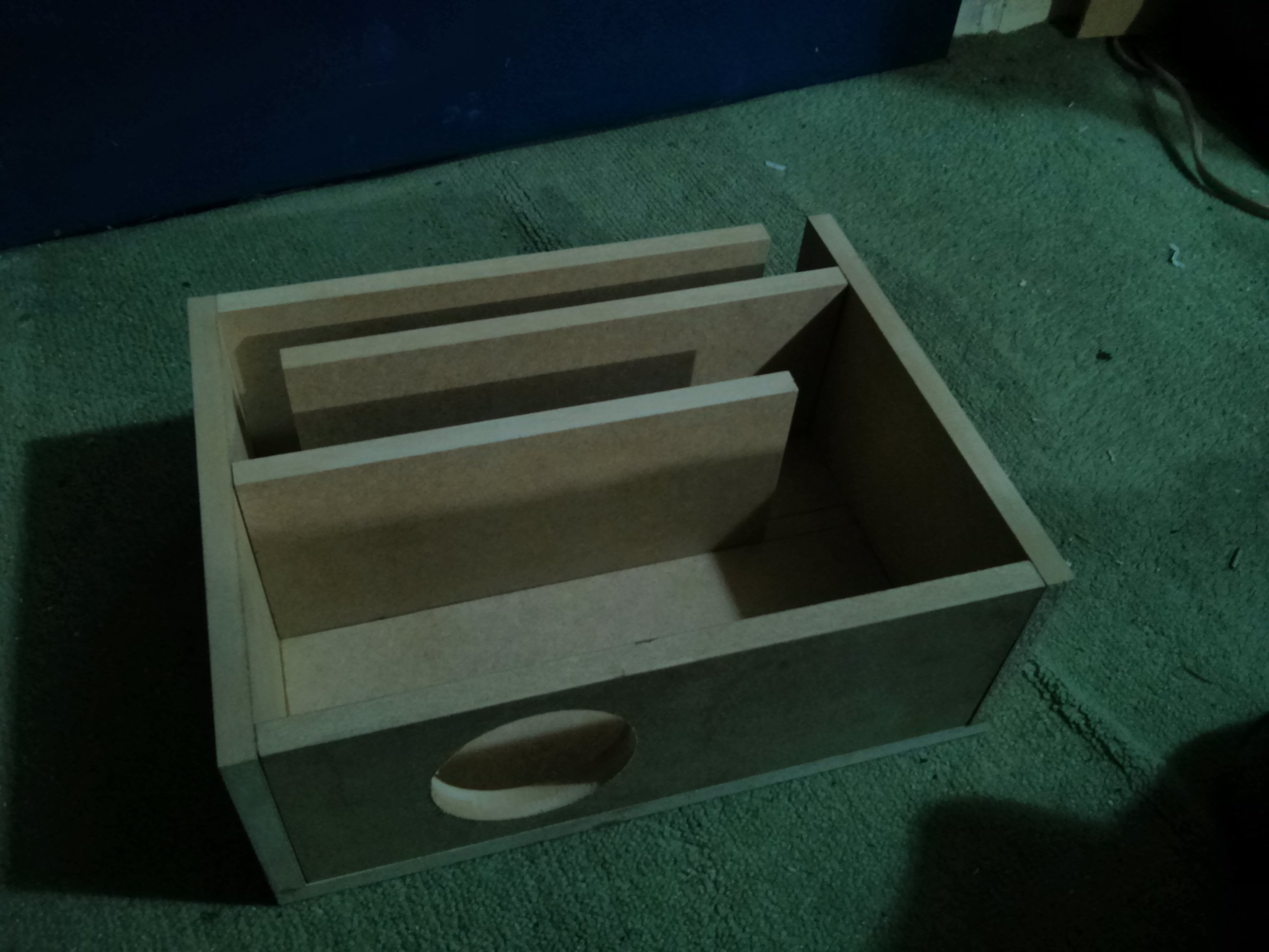

After basic contruction.
2016-03-24%2007.46.16.jpg?dl=0
These are much nicer..... They lack being wall-mountable.... With a rear facing port but reach low for a teeny 3"-3.5" driver. Though they won't go as loud as my Tannoy E11s, they get within a hair of dropping as low.... So somewhere around 55-60 hz.
Not bad for a 3" cone in a 12"x9"x5" box..... If stand mounted they can be built with the port facing down..... Or up if you up-end the design.

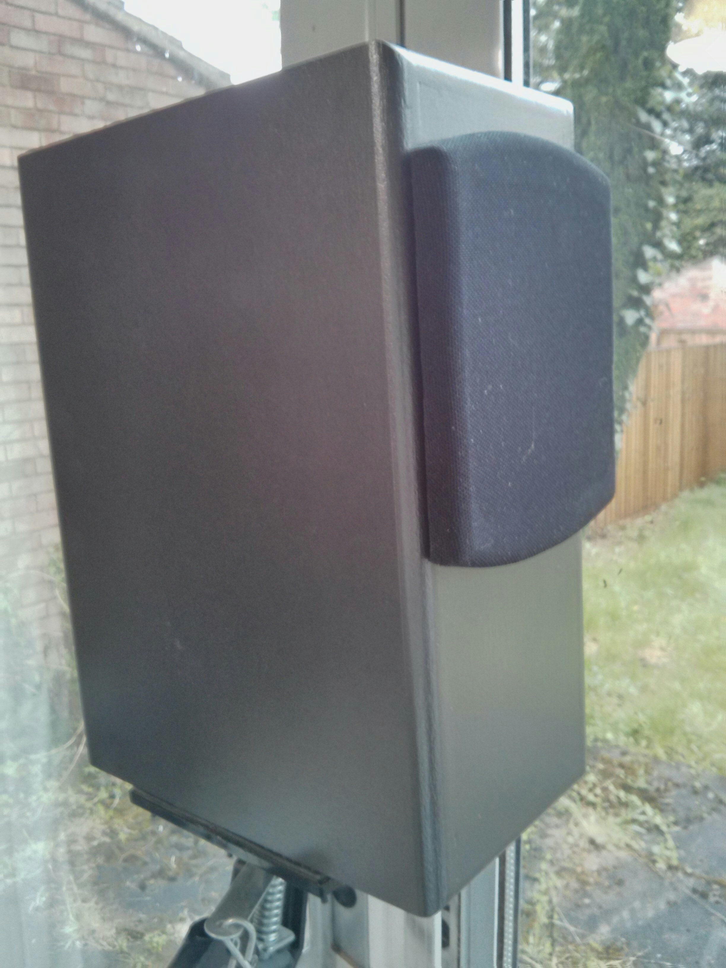

Speakers as they are currently...
