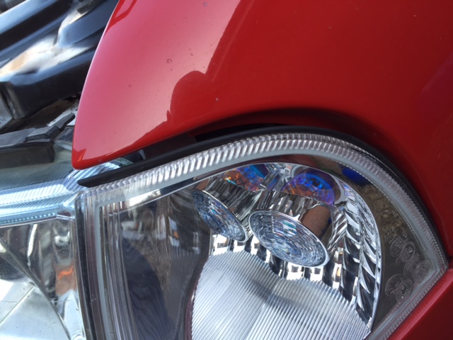

I today fitted some Xenon headlamps from a 51 plate L&K Octavia in which the loom had already been modified so they were pretty much plug and play and working without issue. My car is a 55 plate Mk1 VRS Estate.

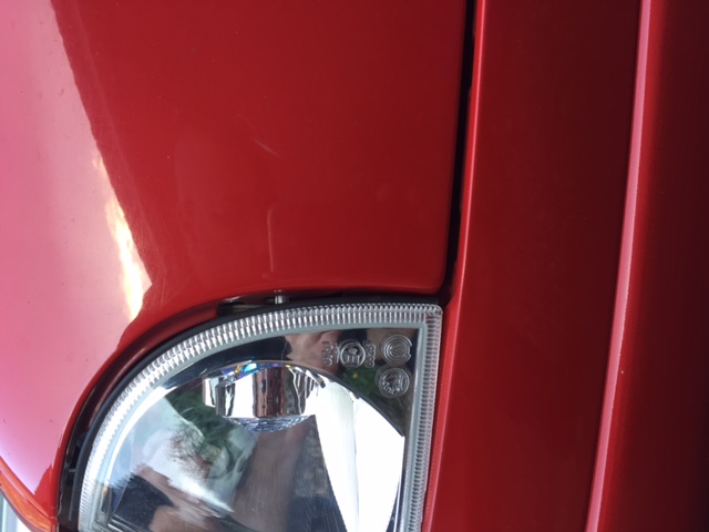

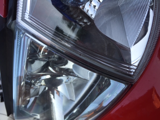

However when i refitted the front indicator lenses they did not line up with the gap in the Wing. I double checked that the headlights were fitted correctly using the 3 main screws (top clips broken on both units however this does not affect the positioning of the unit).
I also checked that both the clips on the indicator lenses were fully slid into the slots on the headlight which they were although very tight. the top bolt also lines up too. However if you look at the photos you can see the gap between the lens unit and the wing.
I refitted the original halogen headlight unit on one side and as expected it lined up fine. I tried loosening of some screws to see if I could get any repositioning on the headlamp unit which was a no go.
This begs me to believe that there might be different types of front indicator lens units for the Mk1 Octy. As far as i know the L&K Octavia was only post facelift?
Can anyone shed any light?

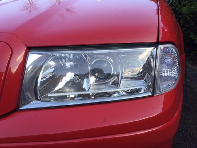

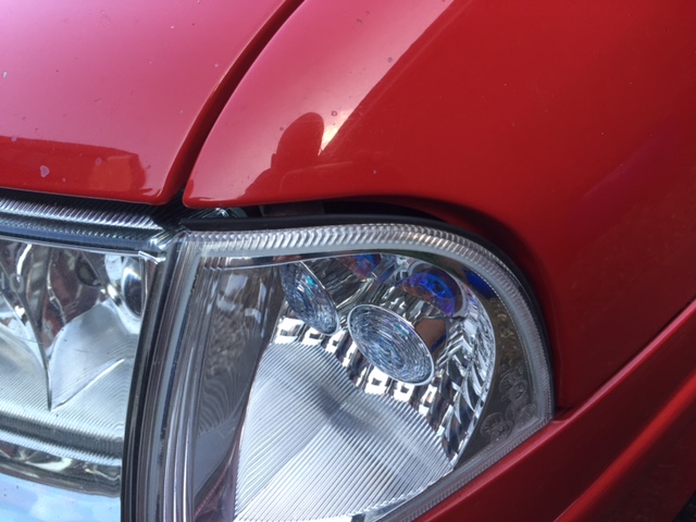

A couple of more pictures.
I am convinced the headlight is in the correct position, all screws fully tightened and look how flush it sits with the bumper.
Also note how the indicator lens looks pretty flush against the headlight too but still has that gaping gap between the lens and the wing.
