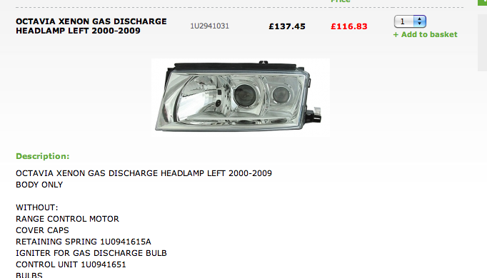

Hi, sorry to highjack but I wanted to know if this lamo fits a 1999 Octavia L&K
http://www.skodapart...2000-2009-50258
OCTAVIA XENON GAS DISCHARGE HEADLAMP LEFT 2000-2009
BODY ONLY
Because where I live the only skoda dealer is quoting me around US$1,000 per headlamp, and on the web all I can find are the ones posted above.
Later I'll figure out how to get these from the UK down to Peru, but I refuse to spend $2,000 on my headlamps (glass smashed in a slight collision, the mount is fine)
Thanks a bunch,
Augusto

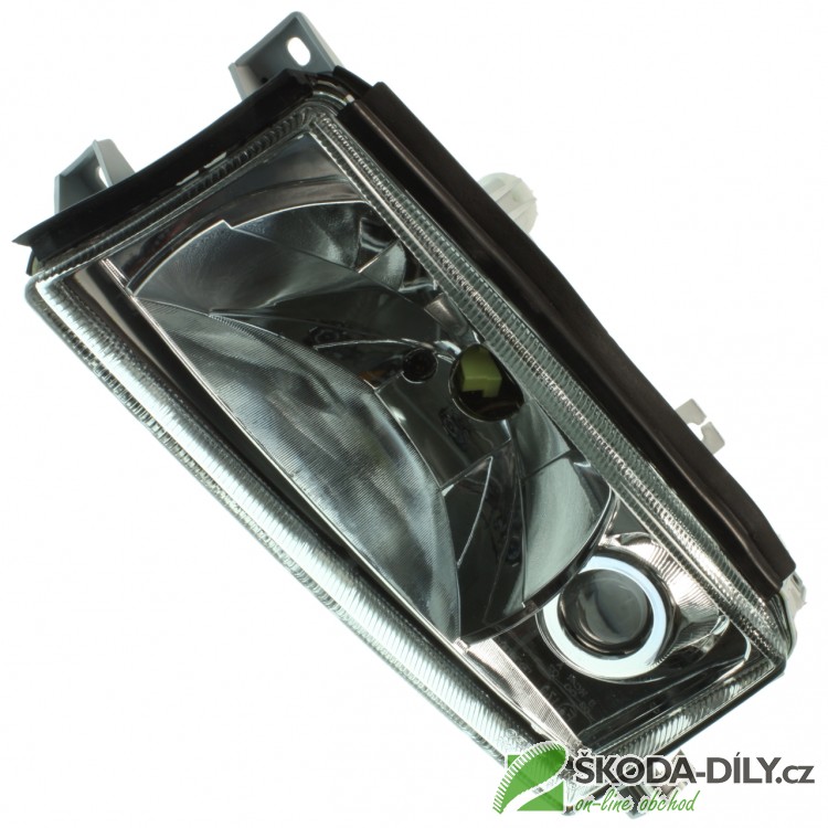

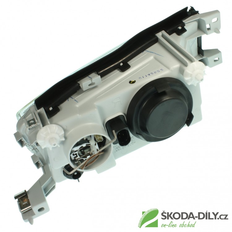

The part numbers are:- 1U1941017B (left)- 1U1941018B (right). They have the (1) side fog lights, (2) the little parking light bulb and (3) the large high/low bulb.Pics from web attached. I'll take some from the vehicle today.Thanks,
Those aren't xenons? There's no ballasts on the rear of the lamps
These are facelift xenons

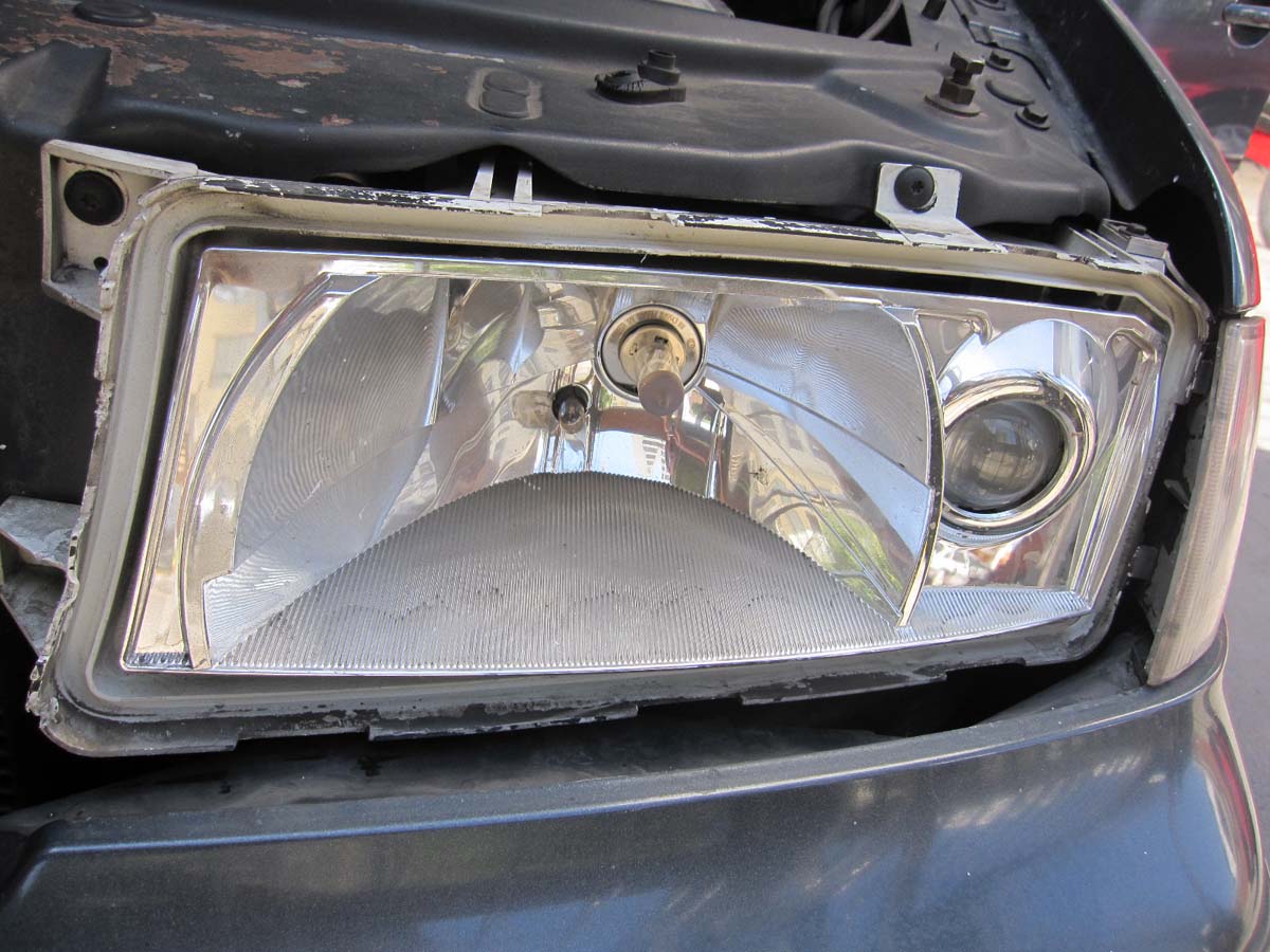

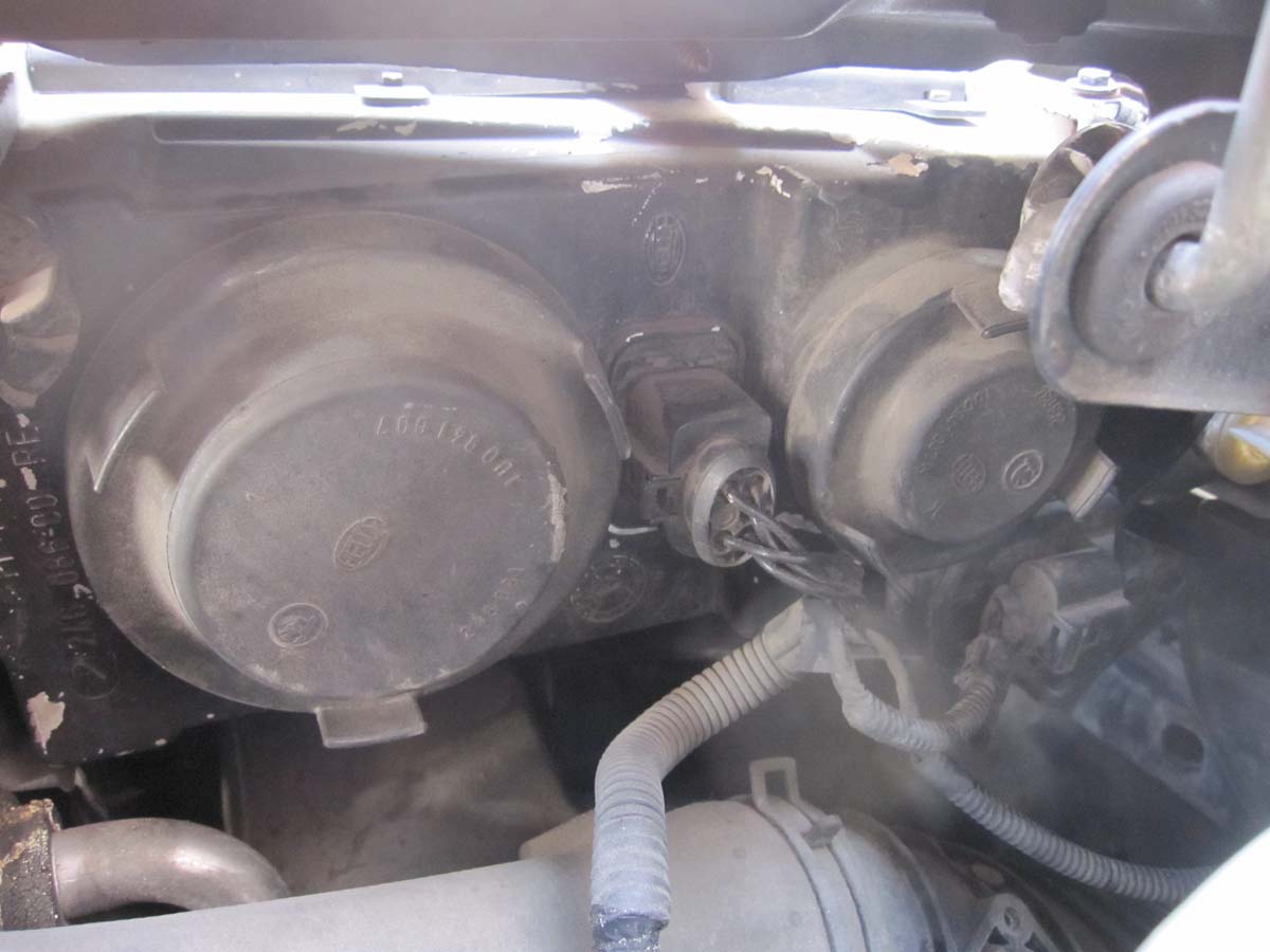

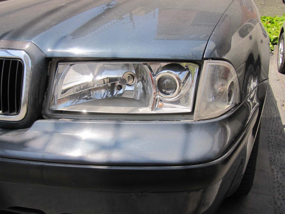

OK, I ran down to take some pics (it's 9:20 am over here).... If you guys need I take out one of the lamps for clarification, can do later...
But basically my searches by part no. come up with those lamps I posted (prices about 150 euro ea.)... Better than the $800 they want to charge me over here!
