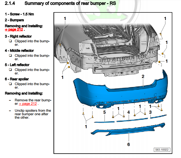

unfortunately that's not the one. The VRS has a long strip that runs the length of the bumper (but I think is made of three parts).
I've tried a few online parts catalogues, and can identify the parts, but there is no part number listed.
(See 30 + 31 on here: http://www.teilekatalog24.info/skoda/Images/Bilder/753/753807550.png )
Edit: see extract from workshop manual. Only problem is I can't work out how to find the part number!

I'm wondering if the left and right reflectors are generic and the centre is the unique part to the rs bumper? If all else fails @ £8.99 it could be worth a punt? I'm sure the Skoda parts desk will have a code and then it's back to google! Any scrappiest nearby that might be breaking a front end damaged vehicle, or a national yard would probably be able to mail one to you?

NSR Tailight 5E5945111A
NSR Reflector 5E0945105A
Centre Reflector 5E0945104A
OSR Reflector 5E0945106A
All for vRS HATCH
Brill, thanks
