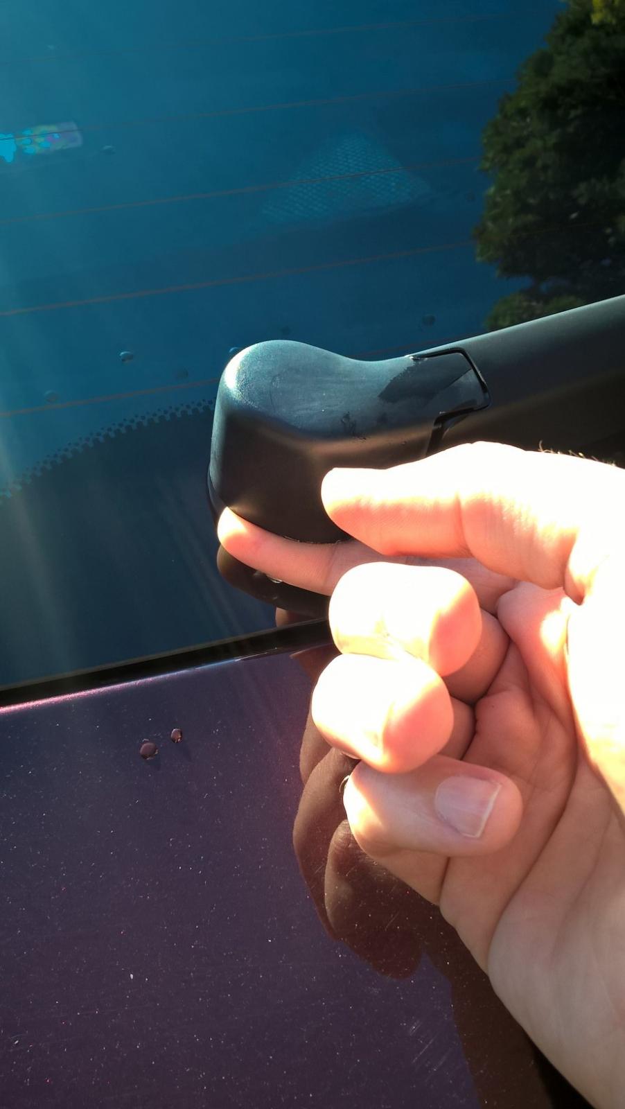

I had the same situation on my estate and discovered you don't need to use brute force.
The trick is to pull apart the sides of the cap starting at the hinge end. This will release the barbs in the moulding very easily and the cap will spring up. Look inside the cap and you will how it is held in place.

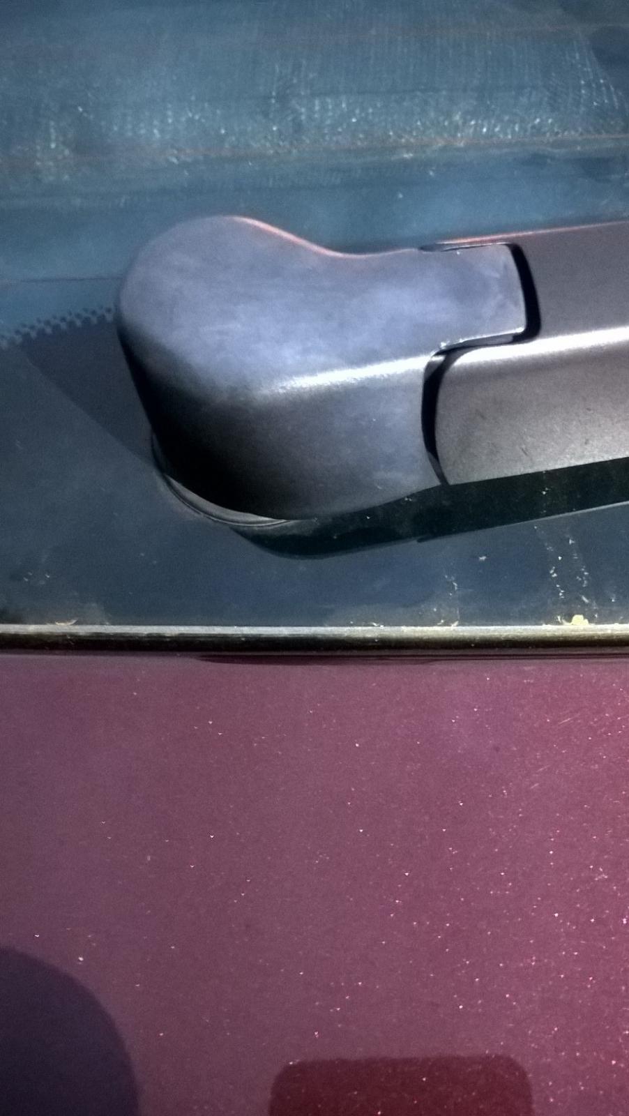

pikpilot, can I just check that yours looks like mine in the attached picture?

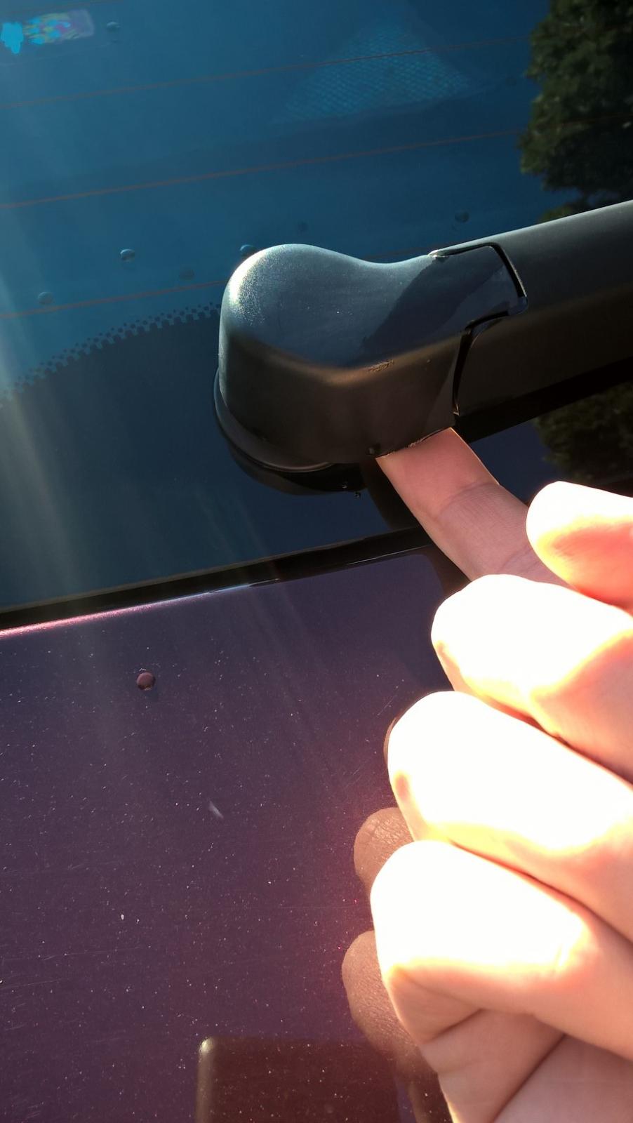

Yes, exactly the same from outside. You can release the sides one at a time. In your picture, put your finger below the side skirt near the right hand side. Imagine you are trying to get your finger behind whilst pulling the side skirt. At the hinge end it is very easy but as you move your finger more the left (in your photo), keep pulling up and left. Suddenly it will disengage the barb at that location. Repeat on the other side.
The different model years and the hatchback may not have the same cover but they certainly look identical.
That worked, came off really easy.

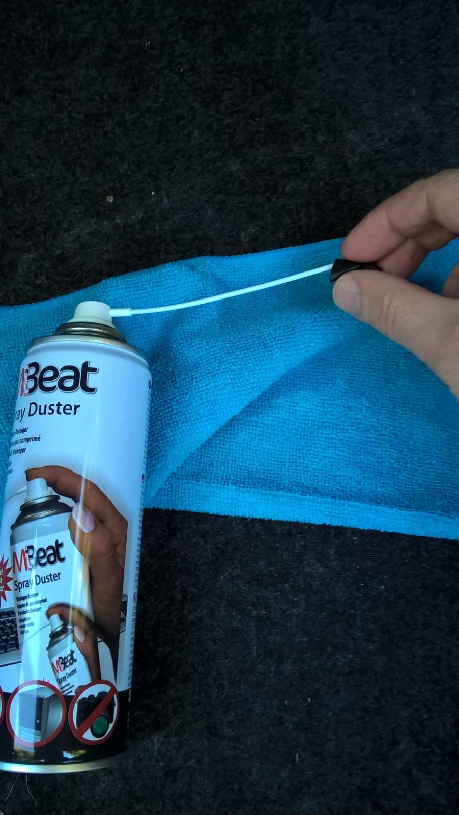

That's it fixed now using the compressed air can that I got for £1 on Poundland.

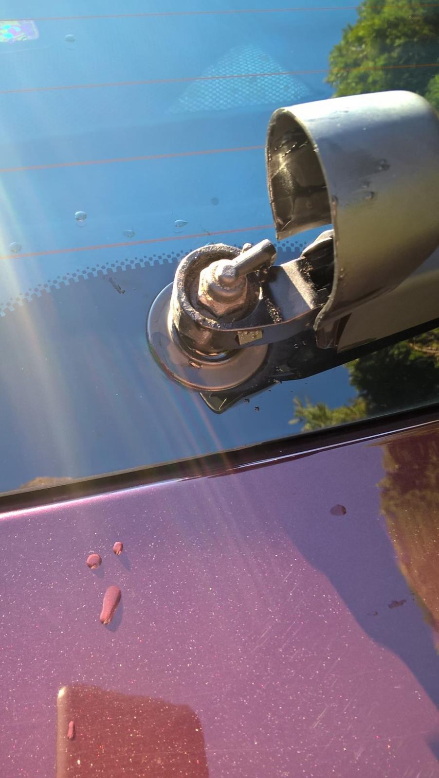

Step 1: Release the cap like pikpilot explained:
Step 2: With the cap off, test the washer to make sure that it wasn't simply misaligned. If it's still blocked, then check to see if water's coming out with the nozzle removed (it simply pulls off). If the water does come out, then yo uknow it's the nozzle that's blocked (or maybe corroded).
Step 3: Use the compressed air can with the plastic straw aligned with the end of the nozzle (where the water should be coming out). Do it on both nozzles. I sprayed each nozzle for around 20 seconds and it took a few seconds before I felt air coming out the other end. One nozzle was so badly blocked that loads of little dirt particles came flying out and l landed on my hand (should have taken a picture of that):
